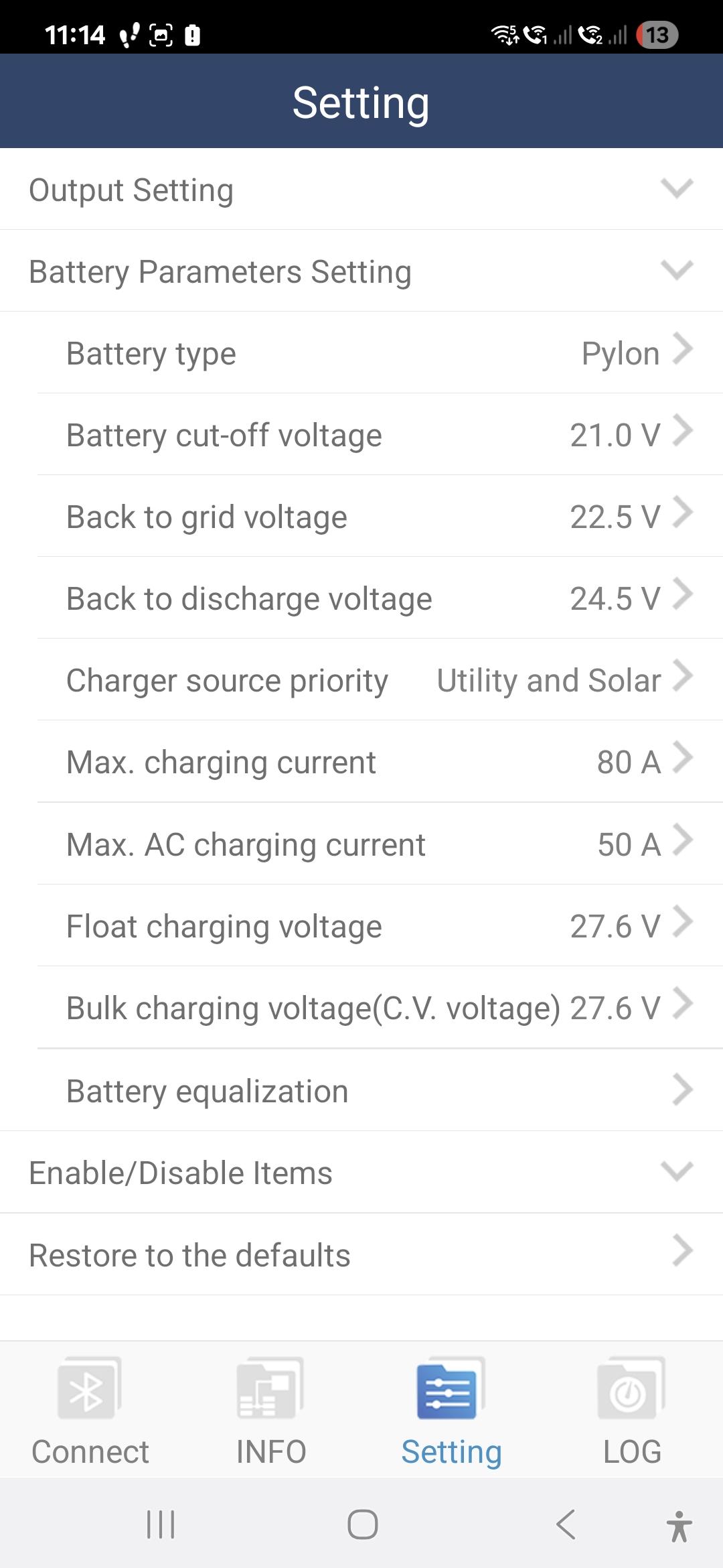

October 7, 2025Oct 7 I bought 2 x BMS JK-PB2A16S-15P for my two batteries and I wanted to connect them to my Voltronic Axpert VMIII 3kW-24V inverter. I found that in the menu in item 05 I only have 3 items, namely AGM, FLD and USE, there is no Pylontech and nothing else. I have the inverter connected via RPi4 to Solar Assistant, where in the settings I can change the type of battery connected to the inverter, but I don't think anything will change in the inverter, because there are no similar settings in its menu. I have attached the label on the inverter, with U1 being 20.58, U2 being 01.12 and U3 being 00.21. Can anyone recommend an update for my inverter so that I can connect it to the mentioned JK BMS?https://photos.app.goo.gl/bz2Q8q94P77jfWuC7https://photos.app.goo.gl/C8E65WNL3RqG9xjJ7

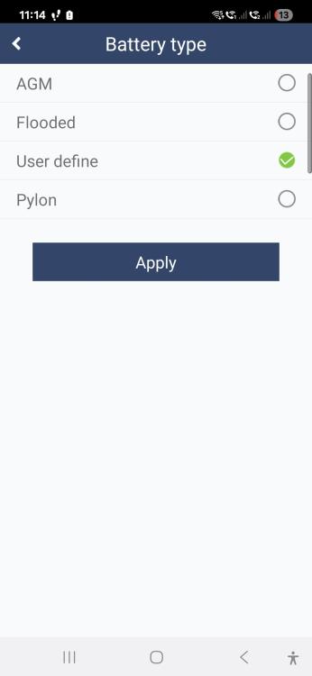

October 14, 2025Oct 14 Author Interestingly, the WatchPower mobile app also has a "Pylon" option, which can be saved, but when viewing via the removable panel, there is no such option and "User" is still set.

23 minutes ago23 min Author 23 hours ago, hmid said:I have the same device do you talk and recognize the lithium batteryYes, the menu will change and items for LiFEPO4 will be added.
