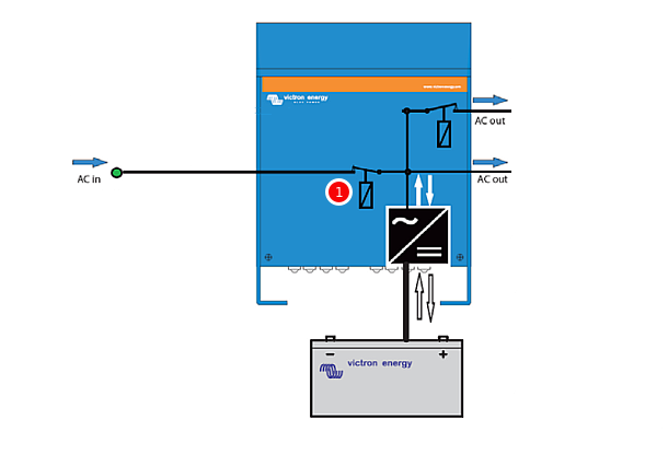

That's how I understood it. Take a look at the typical diagram of a Multi:
The backfeed relay is marked with a red number 1. When the inverter is running grid-parallel, that relay is closed. The inverter component (black box with the = and the ~ signs) is on and moving energy either into or out of the battery. So if you put a changeover on the output side, while it is extremely handy, the battery is technically connected even though we haven't islanded yet.
If the grid fails, the backfeed relay is opened. The battery remains connected, the inverter remains on, the loads on the output remains up.
There is one difference not illustrated here. The NRS-approved inverters have two relays in series and two redundant control circuits and they disconnect the grid as required to form an island. Now the entire time we were discussing this, I thought this method of islanding was against SANS, and that SANS would have to be amended to accommodate it.
