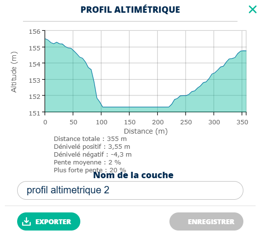

What do you think of this elevation profile? It's a water reservoir for agriculture with a fairly shallow depth of about 5 meters.
Based on the elevation profile, the reservoir has a relatively flat basin with ~4–5 m depth and manageable bank slopes. This is technically suitable for floating PV with deadweight anchoring. The key parameters to confirm would be seasonal water level variation, sediment strength, and wind exposure rather than depth itself.
