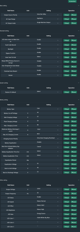

I am gonna include images of our settings. Is there anything here that will cause a battery to fail like that. considering the US2000C seems to be fine

I'm Running a Rantech Max E 11KW invertor with 3 X Rentech batteries in the attached as i have also attached a screenshot of my invertor configuration and so far I'm doing well, my only issue is I'm running on User for Battery setting as i cannot find the correct communication cable between my batteries and invertor, I have noticed you are using a comms cable. If you don't mind sharing type of cable are you using and what configureation is it.tanx
