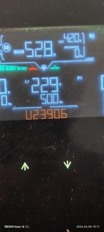

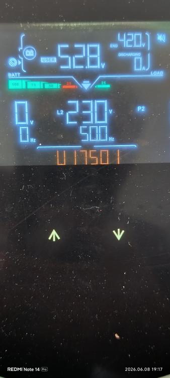

Hello everyone I am new in photovoltaics and I have just acquired an inverter, does it exist a up to date firmware for the Max II 11 kW Twin ?
Mine was shipped with the version 75.01 for the Main CPU and 39.06 for the secondary CPU.
