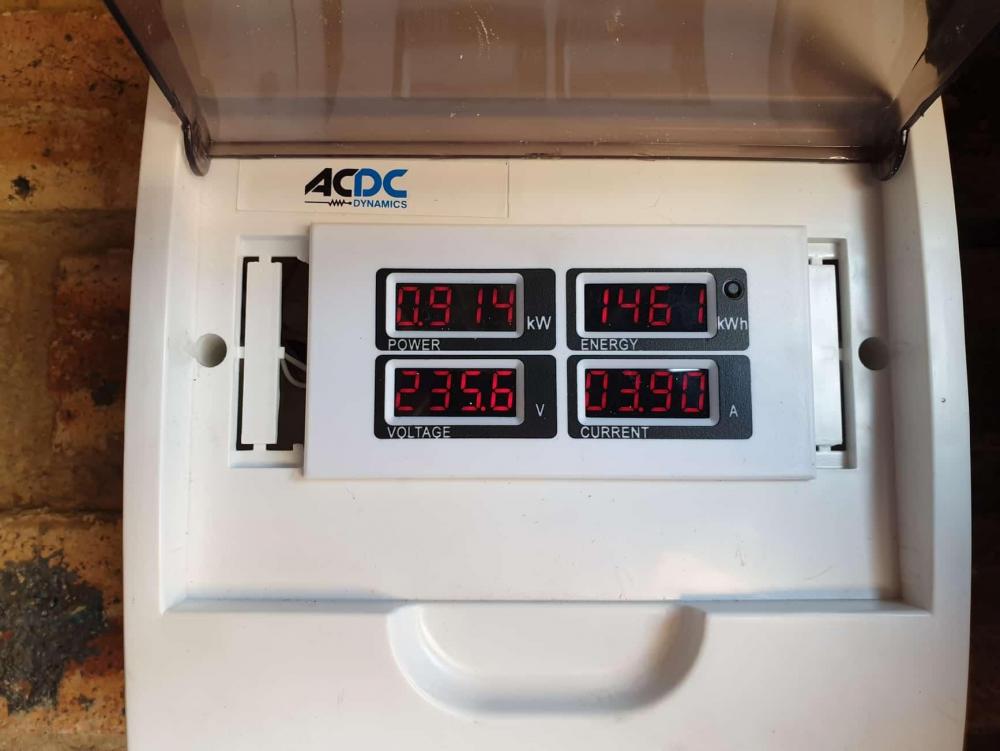

Monitoring, moved my home power usage monitor to the inverter output to see how much is generated until I can get my inverter monitoring setup.

I currently have CT clamp's in the db there on the end you'll see small wire coming out. Trying to hide it.
This goes through MQTT to the server and then I have a laptop on a table that is not in the picture. This uses RS-232 to control the inverter export. The meter is on the other side of the wall.

From what I can track from the CT clamp the production as follow. Saturday after installation 3kwh for the day and yesterday 5.2kwh for the day.
