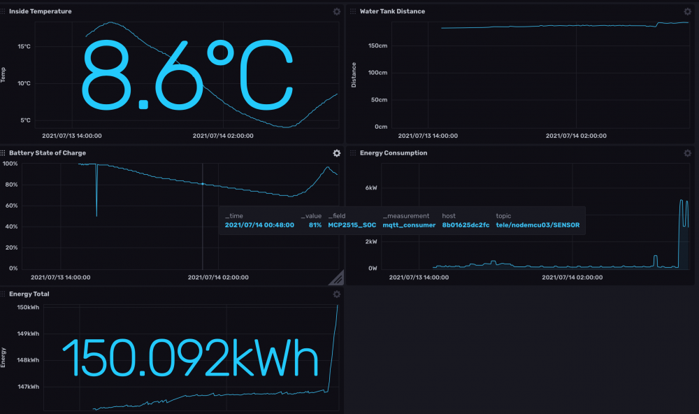

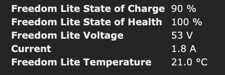

Bezuidenhout Posted July 14, 2021 Author Share Posted July 14, 2021 (edited) Just got my first version working getting the SOC and some other information from a Freedom Won Lite battery on it's CAN bus. The hardware units are an ESP8266 and a MCP2515 CAN controller. Edited July 14, 2021 by Bezuidenhout Quote Link to comment Share on other sites More sharing options...
