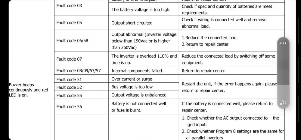

Hi @Lungisani, do you have a wifi dongle connected to your 5000es?  You can then download the app on your smartphone, log in and register your inverter. All the faul codes will appear on the app with time and dates when it happened. you can then see what the discription of the problem is . You also get a code error 9 when the batteries is over charged. I sorted mine and all OK.
