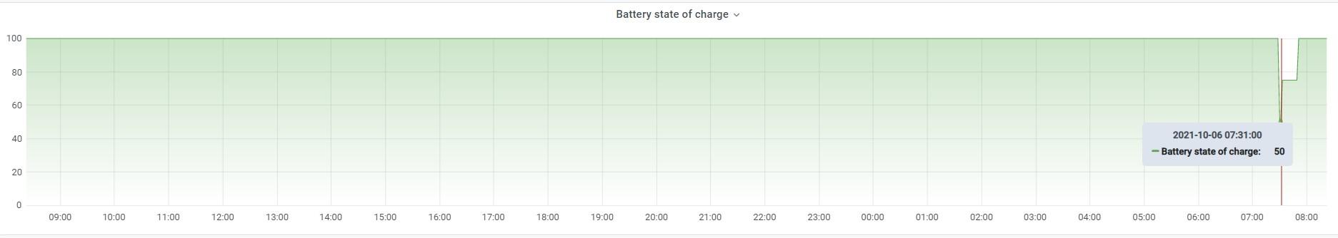

Every morning when the Solar charge controller kicks in and PV power starts trickling through I notice a significant drop in SOC as reported in the Growatt App as well as Solar Assistant.
Logs show the battery SOC goes from 100% all the way down to a reported 50% and then within a short period back to 100%.
This happens every morning just as the Solar Charge controller kicks in. SA-1.thumb.jpg.9d86423ff7441f6dd6140f642cea84a6.jpg
I'm wondering why this happens and if my battery bank health is being compromised in any way by this happening. Chalked it down to a glitch in the SOC state reporting but it's starting to bother me now.

@JoeyhZAhi it's nothing to worry about. The SoC that you see without a bms is just a guesstimate based on the voltage the inverter sees.
The voltage drops when your inverter switches to Sbu from bypass the load drops the battery voltage.
It's normal baviour  with gel/SLA batteries as they don't have a bms. Or any accurate way of reporting SoC.
