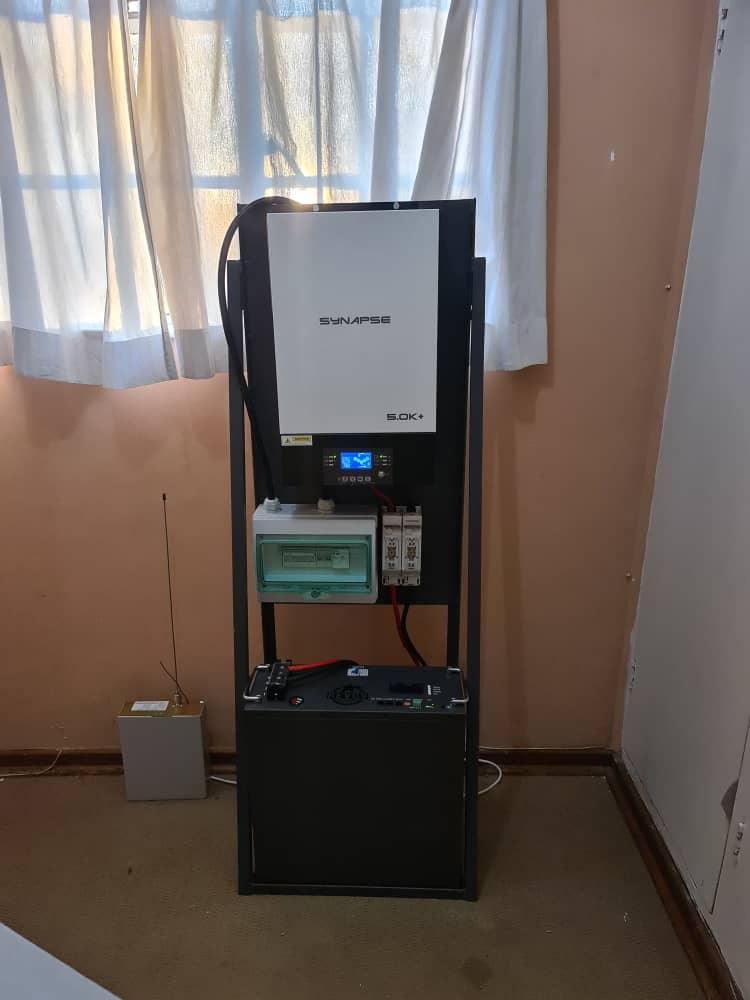

I have been involved in two projects like this. One was for a rural home where the walls weren't strong enough to mount the inverter and we used a small 1.5kVA unit to power some lights and a fridge for the owners insulin supply. The other was for a someone renting that didn't need the solar panels and didn't want to have a permanent solution. Both worked out well. Revov make two off the shelf products with their batteries that are similar in concept, the "Star" and the "Cube".
I would say you only really have to careful about the power cables and what regulations are regarding connecting into your system.
