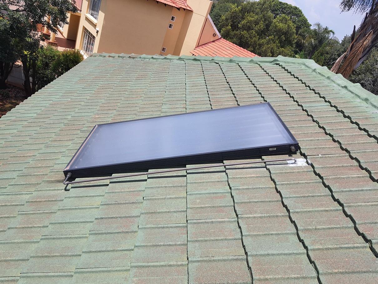

1 x Geyser plate with a Geyserwise control panel.

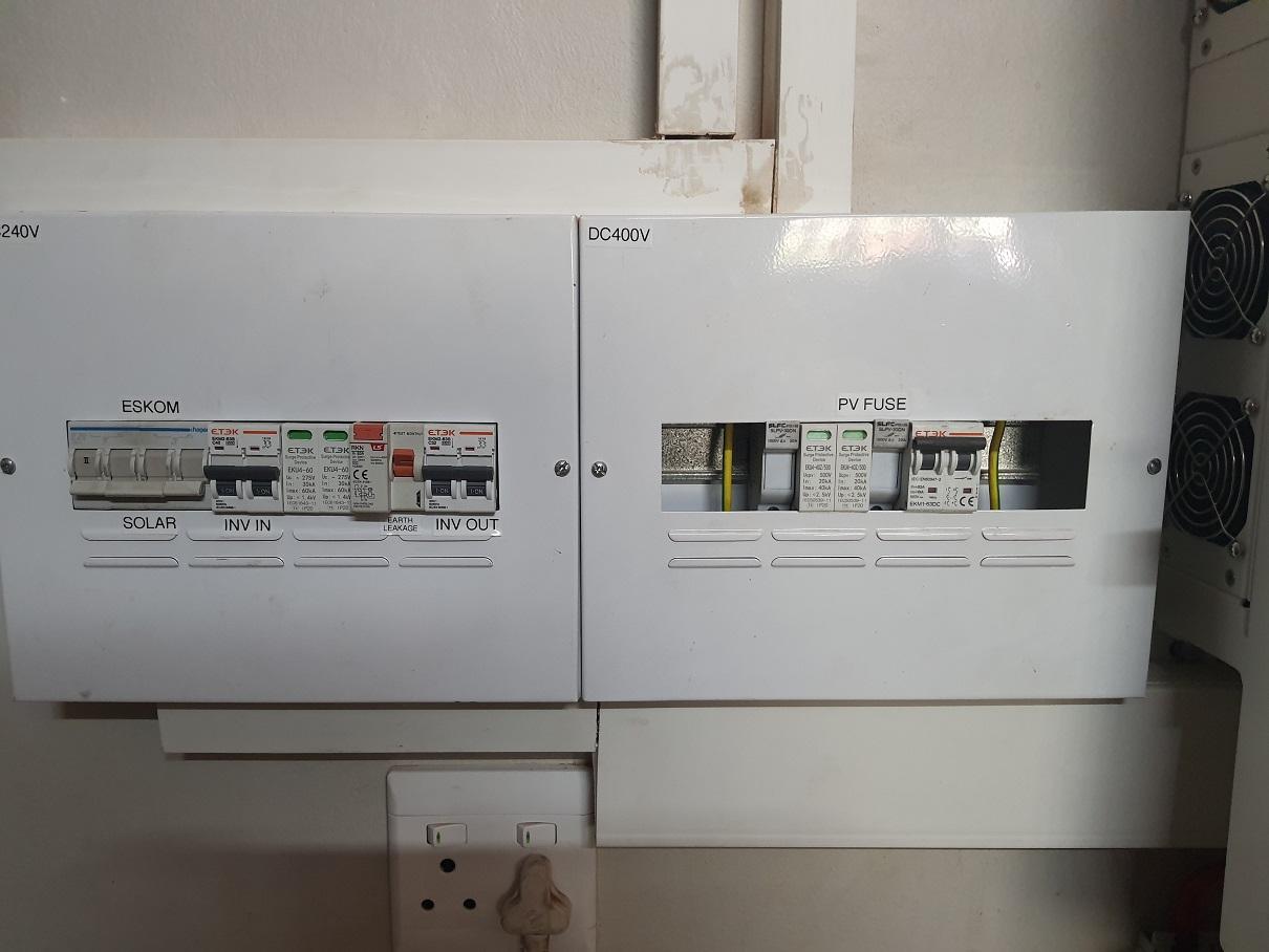

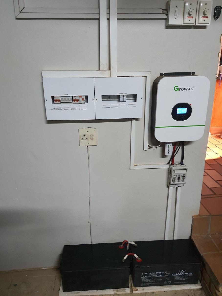

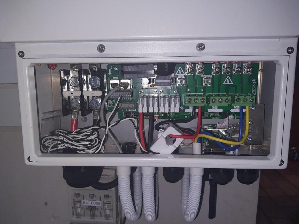

Inverter and batteries. DBs with no blanking plates... Sies!

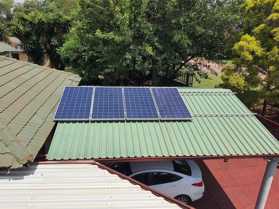

My 4 panels.
Geyser plate.

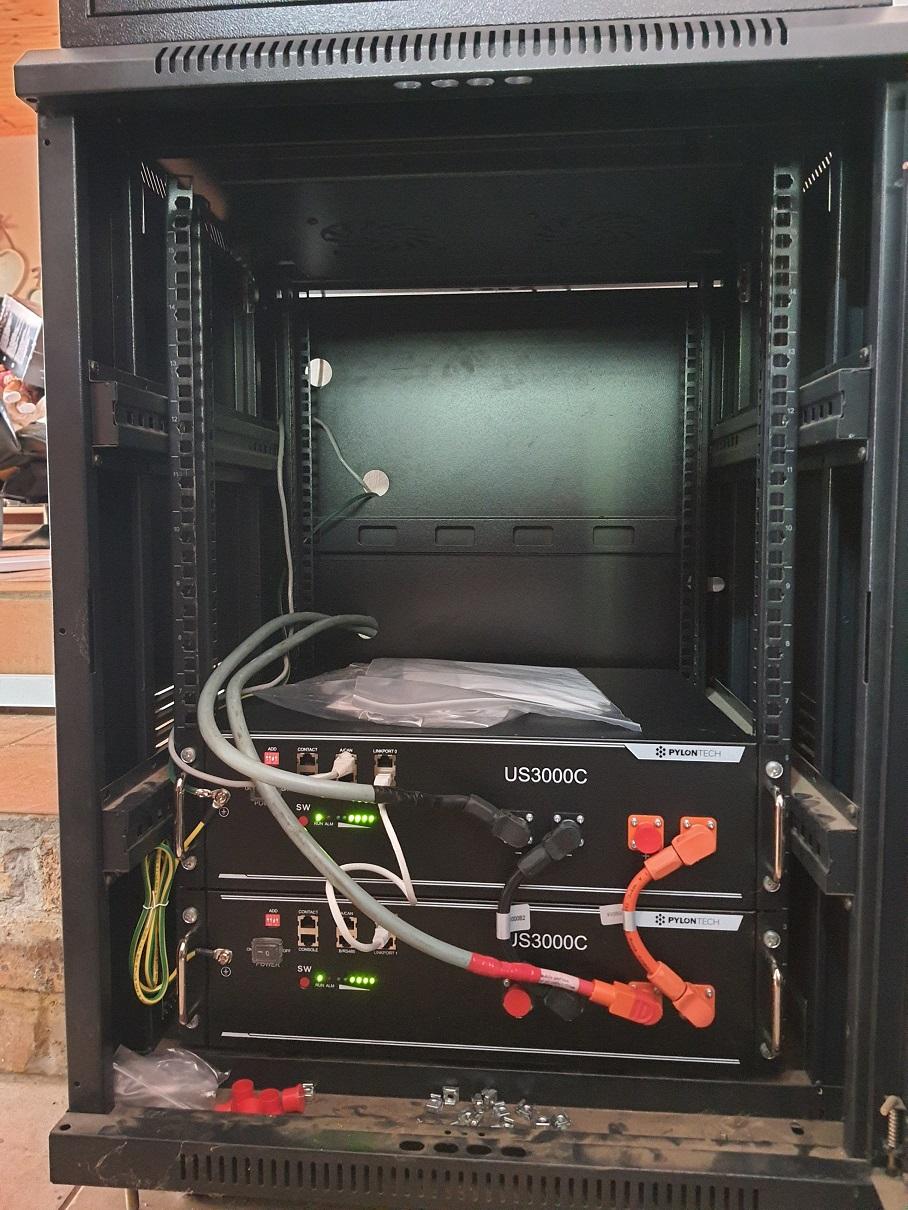

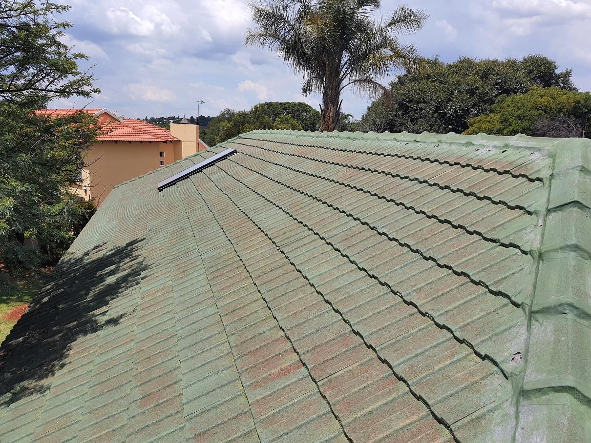

Tomorrow is the day.  I am replacing the Growatt with a 8kW Deye inverter, with 2 x Pylontech US3000C batteries.  I will also be adding two more 330W panels to fill the current frame, mounted on the roof.
I realise that I will be light on batteries and solar generation, but that will have to wait for upgrade version 1.1 or 2.0 or maybe 3.0.

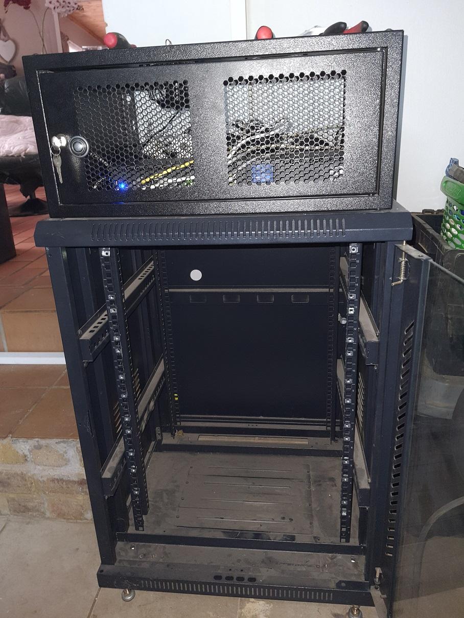

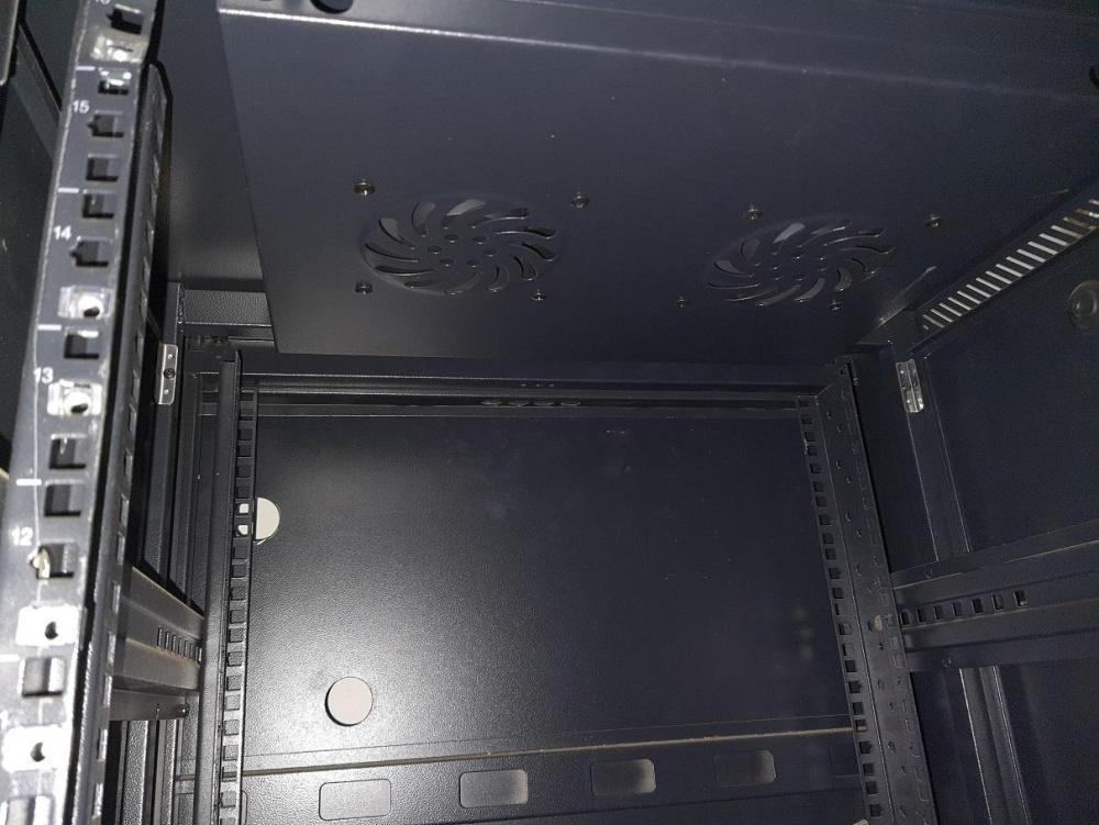

I bought a secondhand 19" server cabinet, where my batteries will live.  It has space for 4/5 batteries, so it's futureproof. While I was at it, I moved my fibre router, PoE's and media laptop into the top cabinet. (the wiring is still a mess).

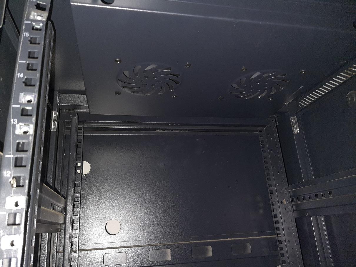

The nice thing about the enclosure is that it already has fans to keep the batteries cool:
I will post more pictures after the upgrade tomorrow, or as the installer goes along...
Part of V2.0 will be to add an array of 450W panels for the 2nd MPPT, as I still have plenty of roof space available:

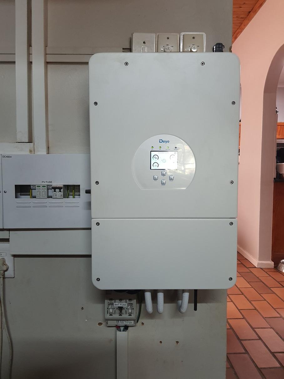

I'm like a kid in a sweet shop. The new equipment has been installed and immediately I can see an improvement on the solar efficiency with the Deye inverter over the old Growatt.  I have been waiting for a sunny day to get an idea of my full yield, but seems like I'm out of luck this week.  Still happy with the performance.  One thing that I note is that I will need to install more PV panels and another battery... Something I knew before embarking on this upgrade.
Some installation pics:

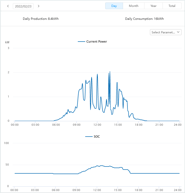

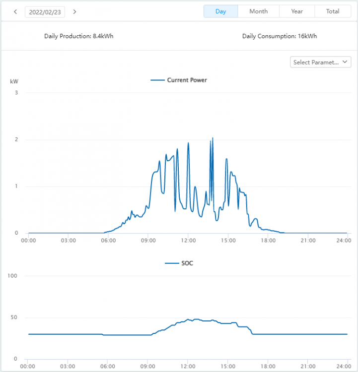

I have set the DoD to 70% as I don't want to sit without power when load shedding hits.

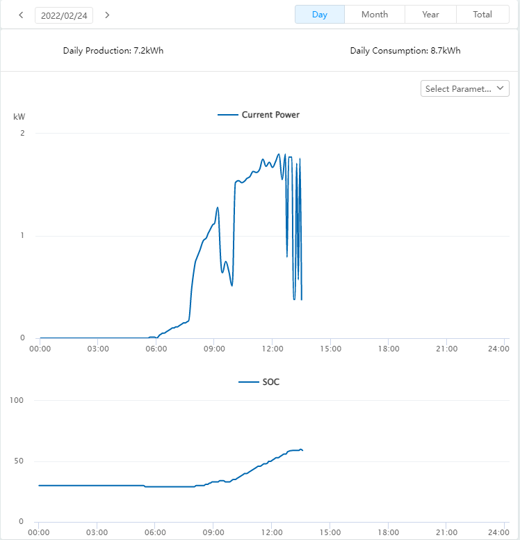

Yesterday:
Today:
Not too bad, considering the total PV capacity is 1980W.
