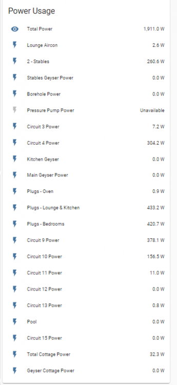

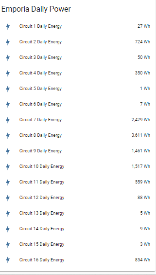

Sc00bs Posted April 7, 2022 Posted April 7, 2022 Hi @uDuWaR I initially started with an Efergy 3-phase which work pretty well and gave me a good general overview of my power usage. I found however that it was not granular enough when I installed my Inverter as it basically just gives you the totals that you are using and I was getting that information from my inverter. I subsequently purchased an Emporia Vue 2 from Amazon which is very good value for money @ $200 shipped as it provides up to 16 x 50 Ct Clamps and 3 x 200A CT Clamps for 3-Phase supply. It will give you the amount of power being distributed to through all the individual breaker circuits on your DB-Board as well as power being drawn through each of your 3-Phases. Delivery took 10 days from Amazon. Just make sure that you order and extra CT CLamp to give you 3 of the 200A CT Clamps as I think it is only supplied with 2 as standard. https://www.amazon.com/Emporia-Monitor-Circuit-Electricity-Metering/dp/B08CJGPHL9 Only issue I had with it was that all the data is getting uploaded to the cloud and is not available directly into Home Assistant and has to be accessed via an Integration. Luckily there someone has done a lot of work and integrated it into ESPHome which is relatively easy to do if you don't mind reflashing the firmware on the unit. Froggie 1 Quote
Sc00bs Posted April 7, 2022 Posted April 7, 2022 With it integrated into Home Assistant I get live individual circuit breaker loads as well as daily usage Quote
