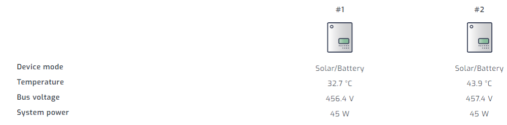

zsde Posted October 8, 2023 Posted October 8, 2023 (edited) Would be interesting to know which series of the 5000ES this problem manifests itself? I have recently added a new 5000ES in parallel to my older 5000ES which was installed Aug 21 and the new one runs 10-15C warmer than the original one. On closer inspection I found that Growatt in their "wisdom" changed the airflow direction. The old one sucks the air in from the bottom placed fans and blows it towards the top. The new one blows the warm air out the bottom, i.e. sucks it from the top. Now these Inverters are marked as Version 2 and Version 4 respectively on the front cover of the manual and there seem to have been 4 Versions of this same model number ever since the series was launched. Up to Version 2 the Firmware versions were the 04X series. Version 3 and 4 had the 06X Series Firmware and the latest Version 4 have the 114 Firmwares. All a bit of a mystery what else has changed between the Versions @Lusan perhaps you can check which version of Firmware your Inverter has. It may well be a temp threshold limit that alerts at a too low a temp and it may be particular to just a series of Firmware. Mine doesn't have any warnings and the temps now in summer are as follows: Inverter#1 being the older one. Something else I noticed is that all the posters seem to have a grid feed which is absent on my installation. You can contact Amos Yang on email or whatsapp, the International Rep in China and give him the full specs of your Version and Firmware and see if there was a known issue and if that has been fixed in the meantime. He is quite responsive with feedback. +8613267189226 [email protected] Edited October 8, 2023 by zsde Quote
Antonio de Sa Posted October 8, 2023 Posted October 8, 2023 3 hours ago, zsde said: Would be interesting to know which series of the 5000ES this problem manifests itself? I have recently added a new 5000ES in parallel to my older 5000ES which was installed Aug 21 and the new one runs 10-15C warmer than the original one. On closer inspection I found that Growatt in their "wisdom" changed the airflow direction. The old one sucks the air in from the bottom placed fans and blows it towards the top. The new one blows the warm air out the bottom, i.e. sucks it from the top. Now these Inverters are marked as Version 2 and Version 4 respectively on the front cover of the manual and there seem to have been 4 Versions of this same model number ever since the series was launched. Up to Version 2 the Firmware versions were the 04X series. Version 3 and 4 had the 06X Series Firmware and the latest Version 4 have the 114 Firmwares. All a bit of a mystery what else has changed between the Versions @Lusan perhaps you can check which version of Firmware your Inverter has. It may well be a temp threshold limit that alerts at a too low a temp and it may be particular to just a series of Firmware. Mine doesn't have any warnings and the temps now in summer are as follows: Inverter#1 being the older one. Something else I noticed is that all the posters seem to have a grid feed which is absent on my installation. You can contact Amos Yang on email or whatsapp, the International Rep in China and give him the full specs of your Version and Firmware and see if there was a known issue and if that has been fixed in the meantime. He is quite responsive with feedback. +8613267189226 [email protected] Hello @zsde my two usually max temp around 36, see last three days. zsde 1 Quote
zsde Posted October 8, 2023 Posted October 8, 2023 3 minutes ago, Antonio de Sa said: Hello @zsde my two usually max temp around 36, see last three days. That's the typical temps for my original Inverter too in summer. I am so tempted to change the fan mounting plate on the new Inverter to change the airflow direction, but that means opening it up which will void the guarantee Quote
