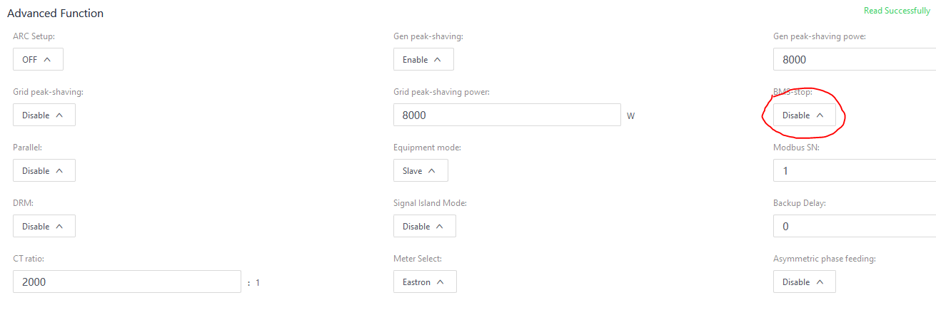

I successfully connected the inverter to Pylontech trough CAN now. It seems that BY DEFAULT (on my firmware at least) , when you try to use Smart Meter and enable it , the Deye will disable BMS ...
The BMS STOP was "Enable" on my inverter by some mysterious reason.
Now it is OK and have comms with Pylontech BMS.
