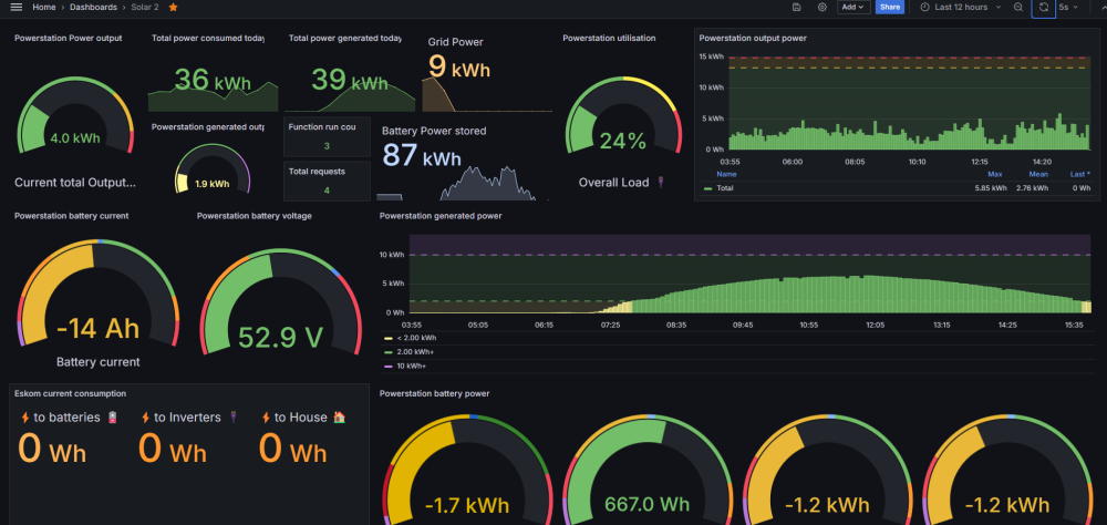

I did however manage to use the DESSMONITOR API (in Chinese) with NodeJS & InfluxDB to then build my own Grafana dashboard so I could aggregate the inverters together the best timing granularity I can get to is 10 minutes as the dongles send ~5 minutes a minute apart about and tried to share the code used to build it all (Not a developer 😏 so my code may be flaky but it runs)
https://github.com/theLarryds/solar/blob/main/README.md

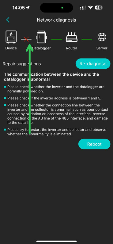

Hello guys,
I have the same exact problem. I got an EASUN 3.2kv inverter and a WIFI plug pro 05 connected to it.
All lights are on. Settings were done correctly and for 2 weeks worked without a problem.
After that, it stopped and just showed an offline device. No more stats.
I tried restarting the inverter, re-done the WIFI connection, removed from inverter for a couple of days then added it back. Removed and re-added to Smartess app with the same result.
Has anyone else had/have this?
Any ideas I can try to make this work again?
