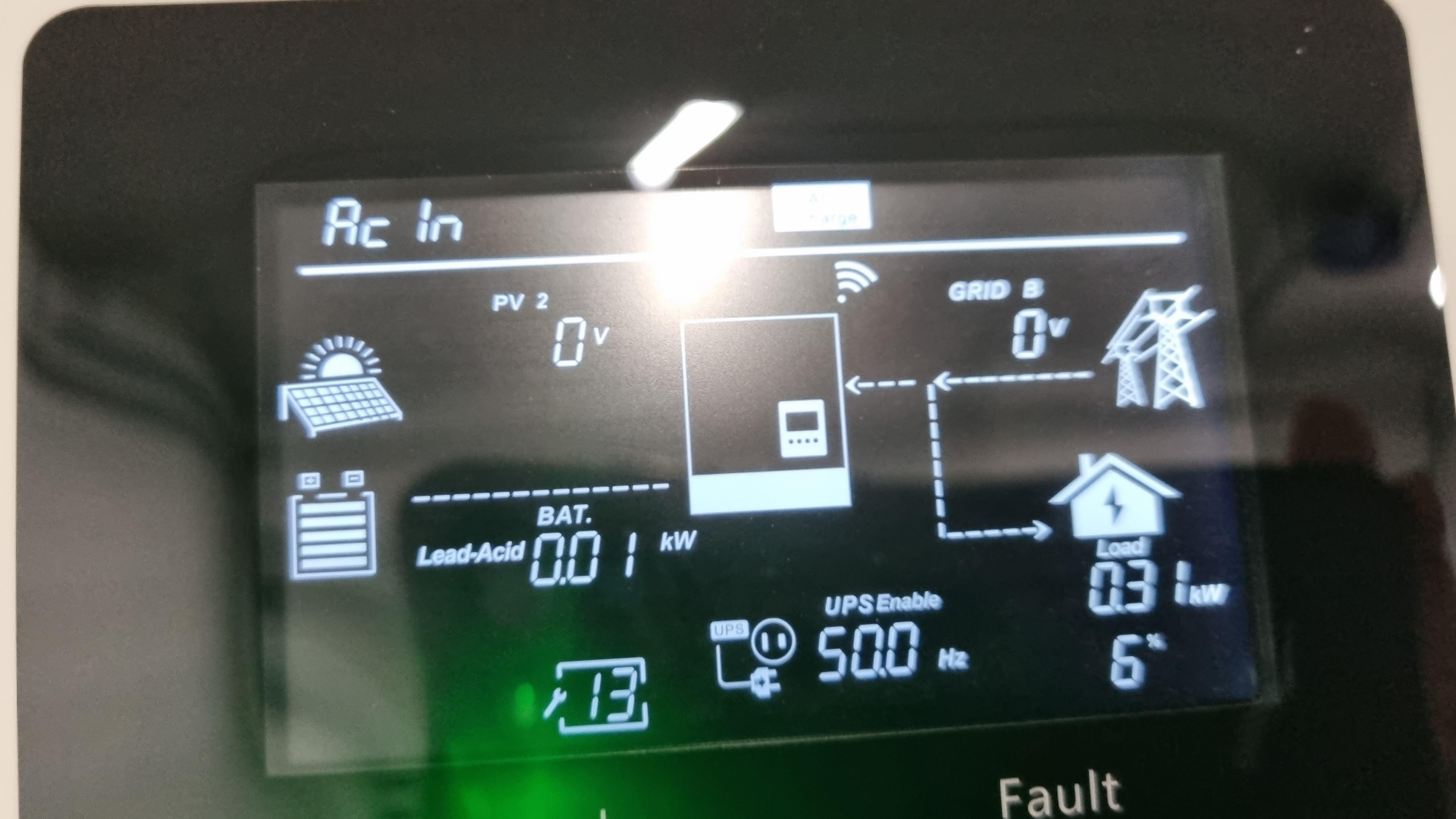

Is your Inverter set in UPS or APL (Appliance) mode?
4 minutes ago, User12345 said:
How do I check if it's Ups or appliance mode?
On the unit, follow the user manual to setting nr 13, let me know what setting it was in.
7 minutes ago, User12345 said:
The above is what I see on setting 13
So it seems to be in UPS mode, if you change to APL it is a longer changeover which may prevent the in-rush current which is blowing the fuse, or possibly surge protection may pick it up if you have. Thats what I am hoping on mine when I get my AV receiver back from repairs, if that doesn't work then I don't know what else is possible.
