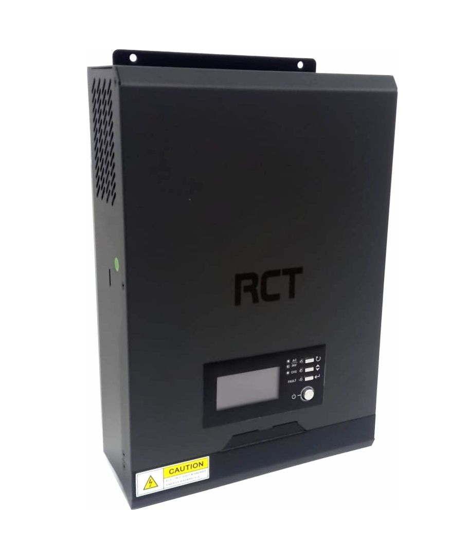

Mom needed a smaller setup for her place to keep a few things running,and I haven't seen anybody posting details on decent 12v Axpert-type inverters so pulled the trigger and ordered this from TA:
https://www.takealot.com/rct-axpert-vm-1000va-1000w-inverter-charger-12v-500w-pv/PLID91107744
I'm pairing this with a 200AH Mecer 2nd Life. All In Cost for cabling,battery fuses,Inverter and Battery ~R15k for 2.5kWh (will be using 80% DoD so 2kWh usable)
s-zoom.file
Bottom:
Takes a Kettlecord connector and has a normal glass fuse on Input side
RS485 and USB-B comm ports on the side. 500w Solar 102VDC Max from panels
15-80Vdc MPPT
