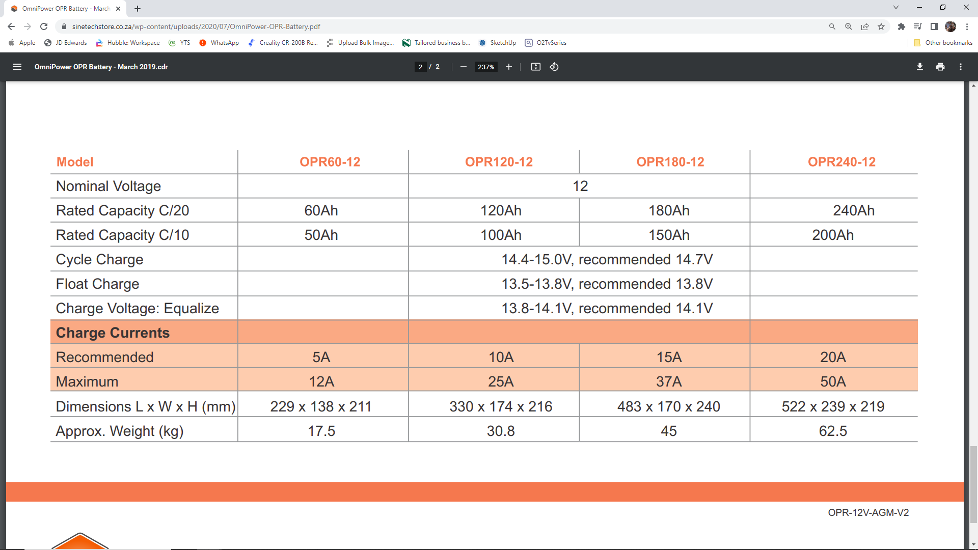

I have 2 x Omnipower OPR240-12 AGM batteries that don't seem to hold their charge. During load shedding pulling 200w they hardly last for an hour or so in a 24v configuration.

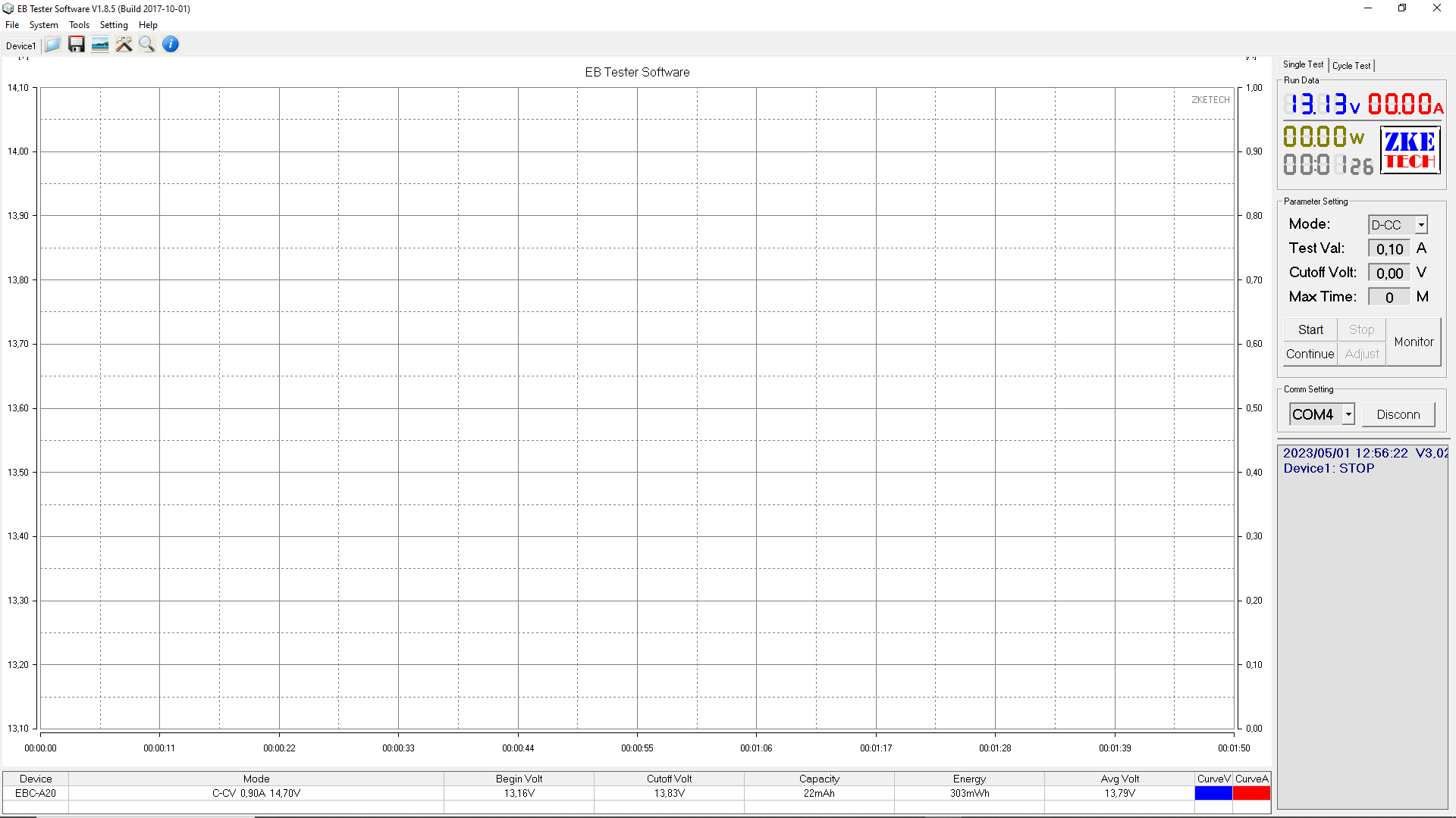

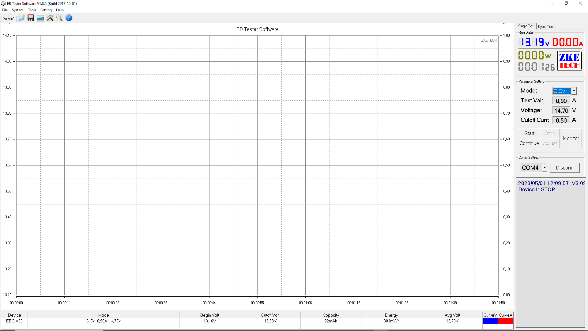

I would sincerely appreciate any help and guidance from forum members on the parameter settings as per the bottom 3 screen dumps below for (1) D-CC constant current discharge, (2) D-CP constant power discharge, (3) C-CV constant voltage charge.

6 hours ago, user19 said:
Charge full then
D-CC 20A volt cutoff 10.8v should last 20hr
Many thanks for your guidance as provided namely on the D-CC screen use "Test Value" = 20A, "Cut-off Volt" = 10.8V and "Max Time" = 20Hrs?
I will start the test after work today. Thanks again. 👍
Edited by DenBeech
Link to comment
Share on other sites
Max time leave as 0

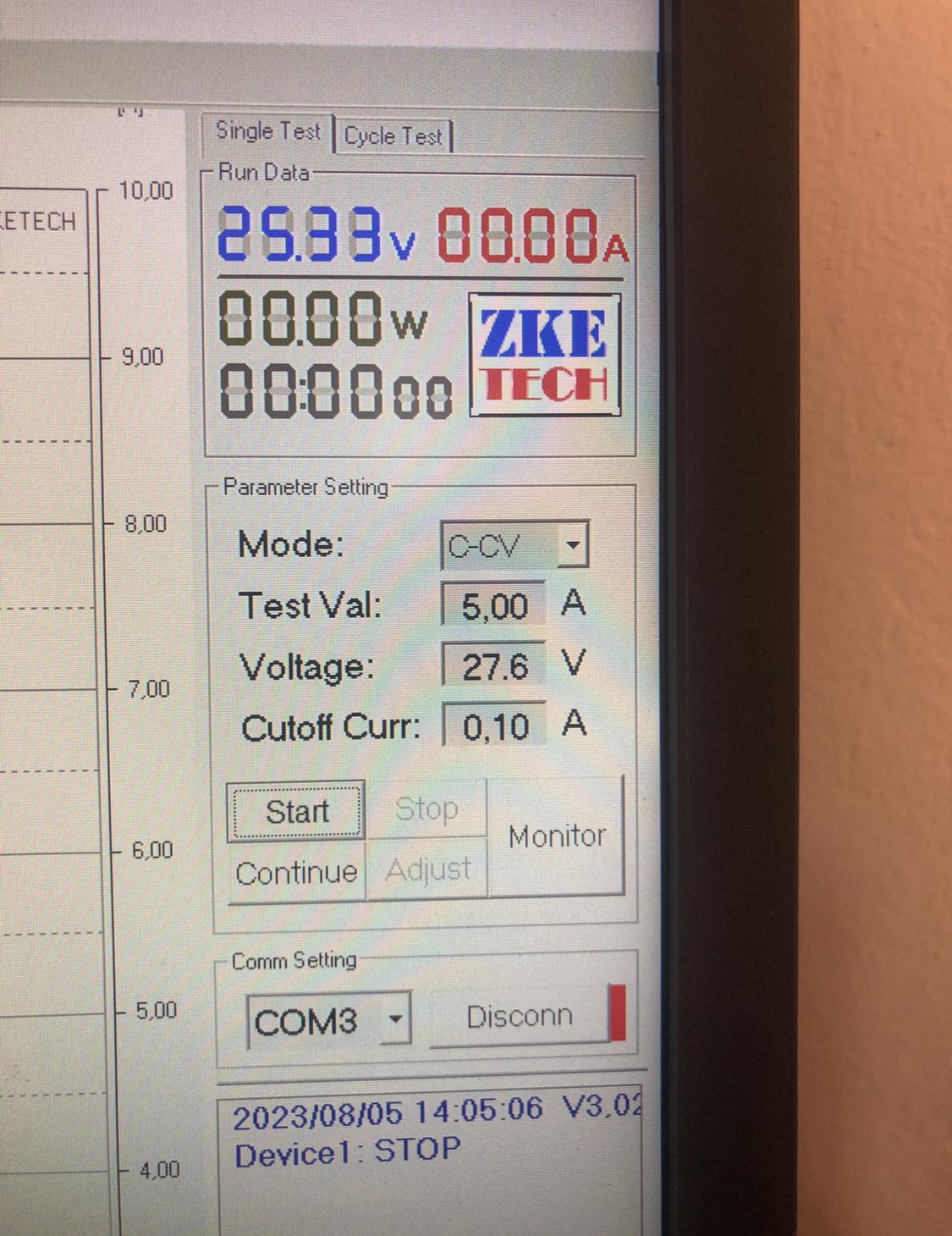

Using the above EBC-A20 charger to charge (C-CV mode) my batteries what would the following parameters be?
Test value |Voltage | Cutoff Current.
The batteries have been running perfectly since Oct 2022 but recently started giving me "wiring error" message on the inverter. So would like to charge them up (now 25.33v) to see if the error persists.
any advise on the settings or otherwise sincerely appreciated. TIA.
