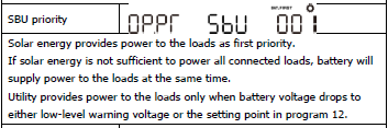

Hi, I dont have a Growatt, but inverter settings are roughly always the same when it comes to priorities, so if it was me and I would want to run off batteries and not grid, then I would do the following:
01 - SBU - Solar, then battery then Grid.
05 - Battery type - Lit (Comms to BMS)
12 - Setting Voltage back to Utility - Here set at your cut off voltage, since you want to run off batteries
13 - Setting Voltage back to Battery - FULL (or as High as it would go if you don't have FULL as a choice)
14 - Charger priority - OSO - Solar only charging (My assumption is you have this configured as SNU - Meaning grid will also assist in charging the batteries at half pace)
What I have personally done also regarding #14 above is have the Grid assist in charging but at a very low current, mine set at 2A, this is just to ensure that the batt doesnt go into the day too low, incase of bad weather etc, like today, but if you are comfortable then just switch #14 to only charge from Solar. You can always if you run low and weather looks bad quickly switch this setting to charge from Grid as a backup.

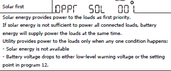

Program code 01 select SOL. It prioritises Solar, then battery and only grid if neither Solar is available and the battery is at it's low level warning.
code 14, either OSO if you only wish to use solar or CSO if solar is only intended as primary source.

Be careful of SOL, if you dont mind a little Grid assistance early morning and late afternoon, but when solar hits 120V (Min 120V), it registers as being available but it really has no firepower yet, and the system will not use battery since, well solar is available. Then it will assist with Grid power as the criteria for using the battery has not been met.
SBU is the same as SOL but with one difference, if Solar is not good enough or absent it WILL go to battery next.
Key words here are - only when any one condition happens - Remember Solar is according to the system available since it registers at 120V, so it will not utilize the batteries no matter what your voltage is set at.
Here the key word are - is not sufficient - So even if Solar registers at 120V early morning but isnt strong enough, batteries will take over.
Now in the evening and using SOL - It will not move to batteries, it will see no Solar - condition met, and Utility will take over, my system set on SOL never uses batteries, it jumps directly to Grid, that's how I want it, as I am not off-grid yet. When I do go full off grid one day, I will change to SBU, and use the batts, and only Grid when I choose as a backup etc.
If that is your practical experience, then I won't argue with that as my Inverter is an off-grid system and I can't test it. Maybe the grid in SOL mode has to kick in if and when the battery power is insufficient to supply the demand?
I can only interpret what the description states. Whether later Firmware updates changed any of this behaviour is unknown.

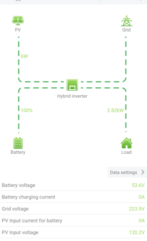

Tomorrow I will try all your suggestions one by one; I have actually tried the SBU in 001 one night, but couldn't see any improvement; I have a graph chart of that whole 24 hour period and there you can appreciate the consumption during the night, being between 300 and 600W "stolen" from the grid that multiplied by the 15 hours I'm running on batteries (theoretically), I'm also using about 400 x 15 = 6 kW of grid power.
The orange line represents consumption and the green line solar; I have the system set to zero dumping to the grid, so most of the time, the orange line covers the green line.
The program and hardware is by Smappee..
Thanks again and will keep you posted

I have set 01 to SbU, but my system is an Off-Grid type. There are only 2 operating modes: either "battery mode" where noting is coming from grid,  or "line mode", where loads are fed from grid and batteries are also charged from grid together with PVs if available. I wonder if you could reach your goal by simply switching off the power feeder to the inverter during that night period. It would then run as an Off-grid system.
