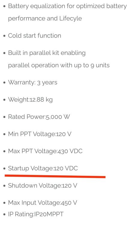

recently installed a VMIII Inverter plus Hubble AM2 battery at my shop. Now I've added 3x 545 watt panels to it( in series). Changed settings to OSO charging the battery etc. All seems to be right..... I can see the voltage is over 130V but no solar production 🥺 no watts nor amps all zero. What could be wrong?

The minimum operating voltage is 120V. Could be that you see 130V but that it drops as soon is it loads the panels.
Just taking a flyer here.

Hi Scorp007,
Please be advised the DC startup voltage for the 5.48  VMIII Inverter is 150v, you would need to add at least 1 more panel to reach the startup voltage.
Thanks for pointing out the mistake. I looked at the Plus version of the 5.48 and not the 5.48.
