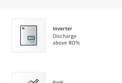

Very good and so much better with fast data rates.
What does this mean though?
Its like having sliced bread 🤣
So that relates to your "Work Mode Timer" under the "Power" tab...or your System Mode settings on the Inverter.
As it stands within the current time period your settings are telling your inverter to discharge your battery until it reaches 80% capacity.
When it gets to 80% it will look for PV if no PV or not enough PV it will look for the grid to  supplement the load.
