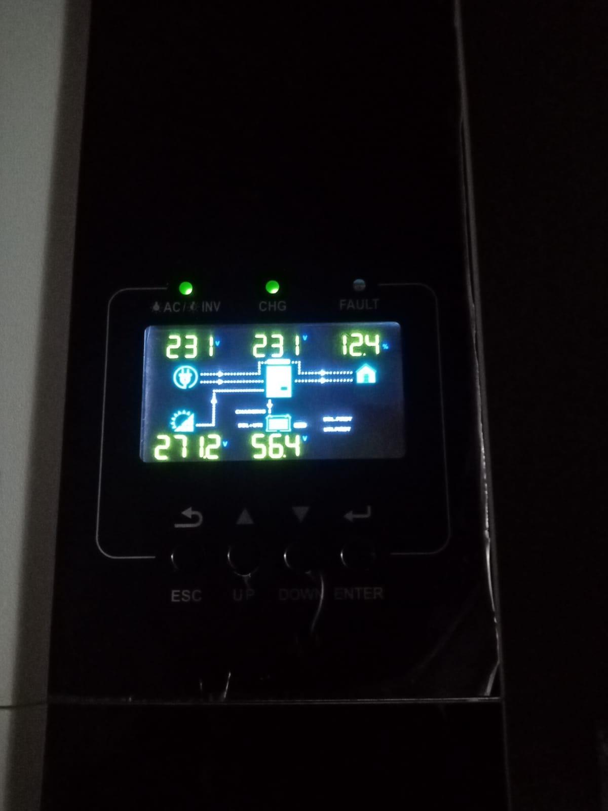

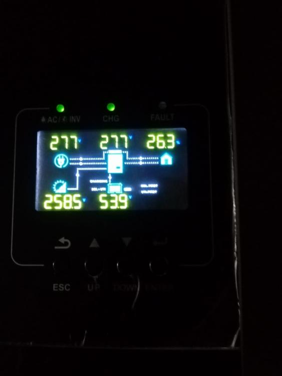

  • The very first pic in the very first post shows 277V grid and Inverter AC out bypass voltage
  • Various pointers have been raised from Friday and sometimes one just have to do some checks to find out what is outside normal limits.  Follow 1 at a time and check the boxes.
  • @AndreAndre There is not much you can do but to contact the council to change the tap on the transformer as @Scorp007mentioned. The inverter cannot controll the input voltage the Growatt specs in
It looks like to me the grid volts are high and so the inverter cuts grid and switch to battery mode .
The 230v 50hz setting only apply to battery mode in utility mode what  the  grid gives the house get til the grid volts go to high and inverter switch to battery mode

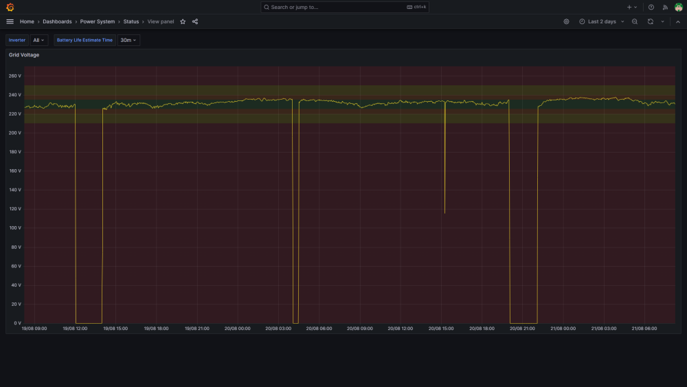

@AndreAndre
The 1st call is to the supply authority to show them the high voltage and hope they will change a tap or 2 on the transformer.
Failing this but at a few thousands will be to add a voltage stabiliser between the grid and your inverter.
Another call would be to change the inverter.

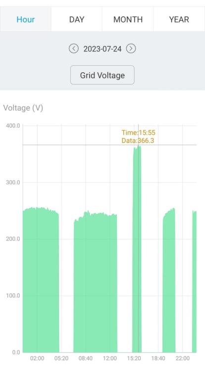

Have you tested the actual grid voltage with a multimeter to confirm that the Inverter Grid voltage displayed is the actual grid voltage.
277V is way above the norm.
Have you also tested with grid disconnected to see if the behavior changes?
That voltage is only when i'ts kicking off. from after noon 15h00 to next morning say 10h00 voltage is constantly normal from grid 230v
And only sometimes it happen that the vots is going higher To 277v.

in cloudy days it's running the hole day with out any problem.
Is it not a setting. I know there is poeple selling power to the grid. Is that setting not on??
