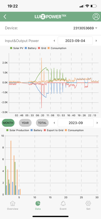

1. I cannot seem to find the PV settings on both the Luxpower iOS app and website that lets me adjust the pv charge settings like at what SOC I would like the panels to start charging, it seems to be set to 10% by default. Each time the battery dips below full charge the inverter kicks in. I would like to set it up to start charging only at SOC 90% (screen shot attached)

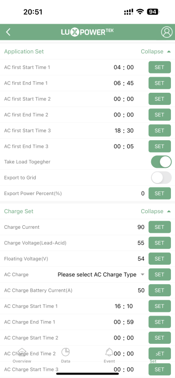

If you click on the Set icon (far right) you should have a screen like this (attached)
You should then be able to set the charge / discharge settings as you see fit based on time/Soc/voltage
