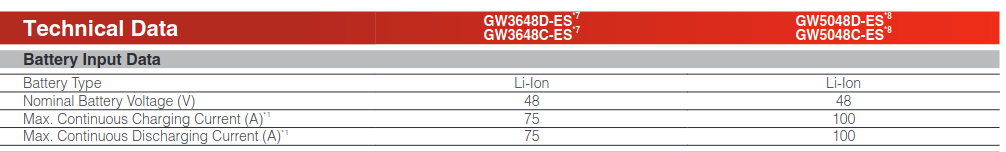

but that limits the charge current to 100A
100A is the max that the inverter can do.
