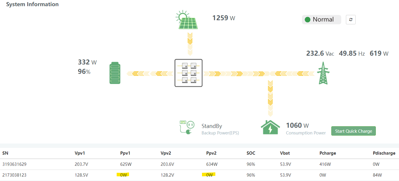

I have 2 x Luxpower SNA5000's connected in parallel. I've got two Solar arrays each connected to an inverter (8 x 480w panels - 4 x panels per string (inverter)). Why is it that although both arrays have sufficient sun (not clouded) but only one inverter's solar is used? I basically have enough solar to produce power to the EPS but only one string/ inverter's solar is used? Is there some settings I am getting wrong? on the attached picture you can see that the inverter picks up that i have an array connected but it does not use the power.
I've just for interest sake changed it 80%. So now its using solar and battery, but still only uses one inverters' solar.. weirdly, now its using the other inverter's solar, see below  pic. As if it does not want to use both arrays at the same time.

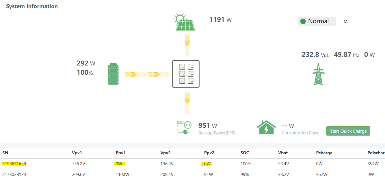

If the strings are the same, why is the voltage soo much lower on the one string? That is even on the string without a load, so if anything the voltage should be higher as when there is a load the voltage would drop a bit...
Something is definitely not right, I do not experience the issue you are experiencing. Check your panels on the string which is not being used - make sure none are damaged or have excessive shading.
If all is good, then maybe move that string to PV2 input on the inverter and see if it makes any difference or if the inverter then starts using power from PV.

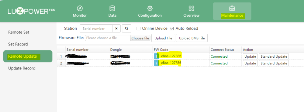

Make sure your inverters are both on the latest firmware as per the below screenshot:
If you do not have access to the Remote Update, then speak to your installer and get them to make sure its on the latest firmware. Get the installer to send a screenshot and the code should match the above.

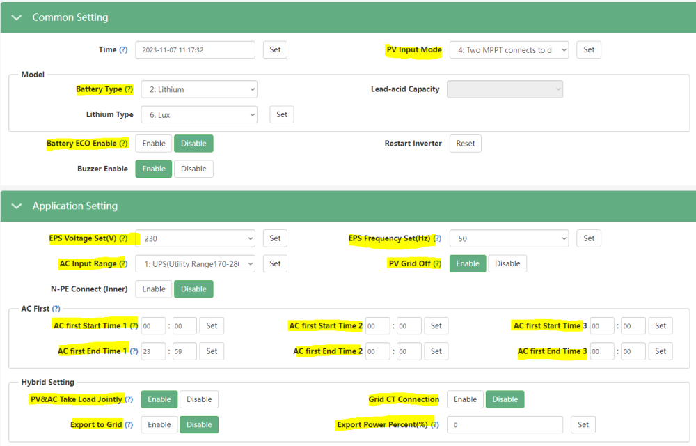

Next, let's make sure the inverters are setup in parallel on the portal as per the below, based on the screenshots you shared I think this is done correctly. Lets double check though:
Then we also need to make sure that the settings for parallel is the same for both inverters:
If the same battery is shared between the inverters then make sure that Battery Shared is Enabled.
With all of the above set correctly, when you make a config change to one inverter via the portal it should automatically apply the same change to the other inverter (ie. Changing the AC first times on the one inverter should change it on both inverters).

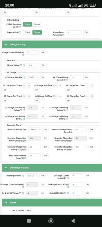

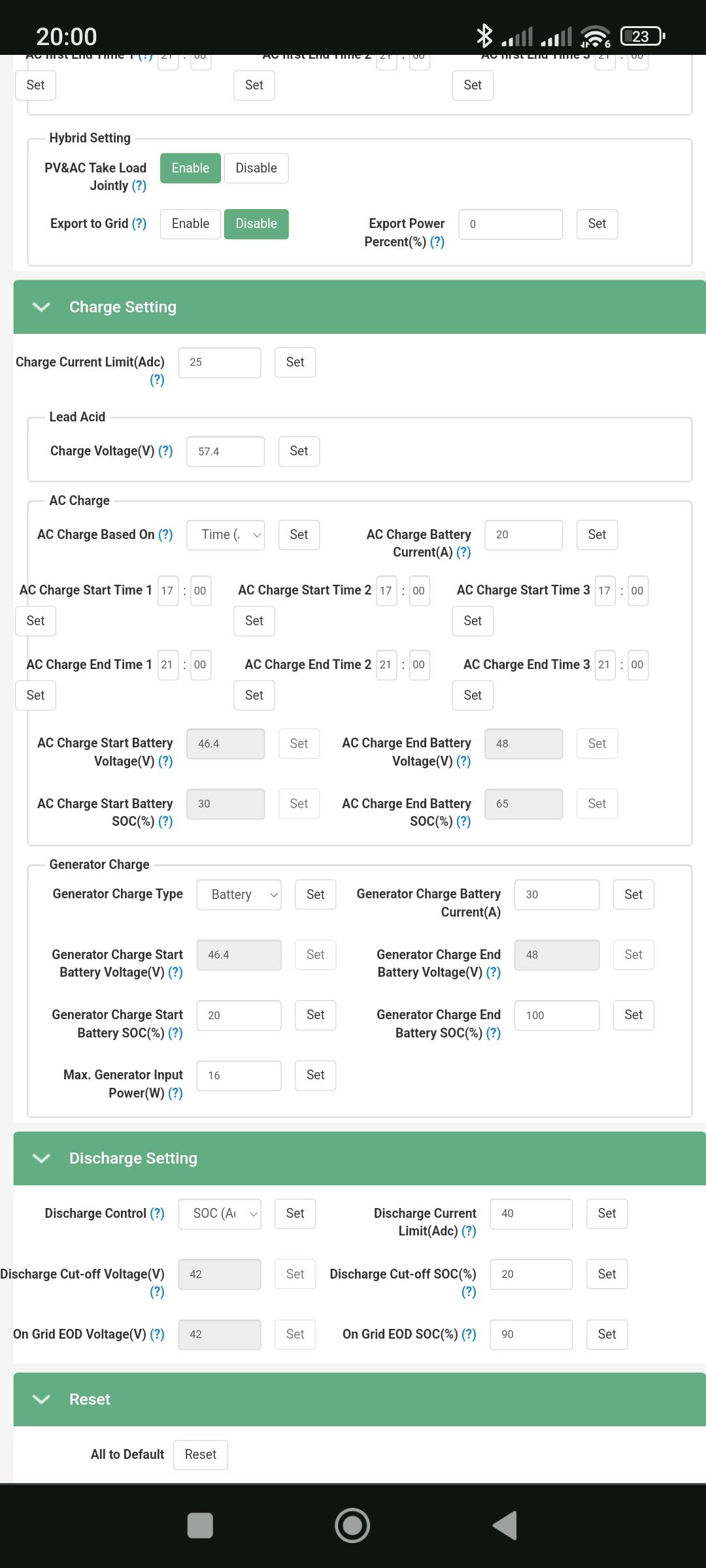

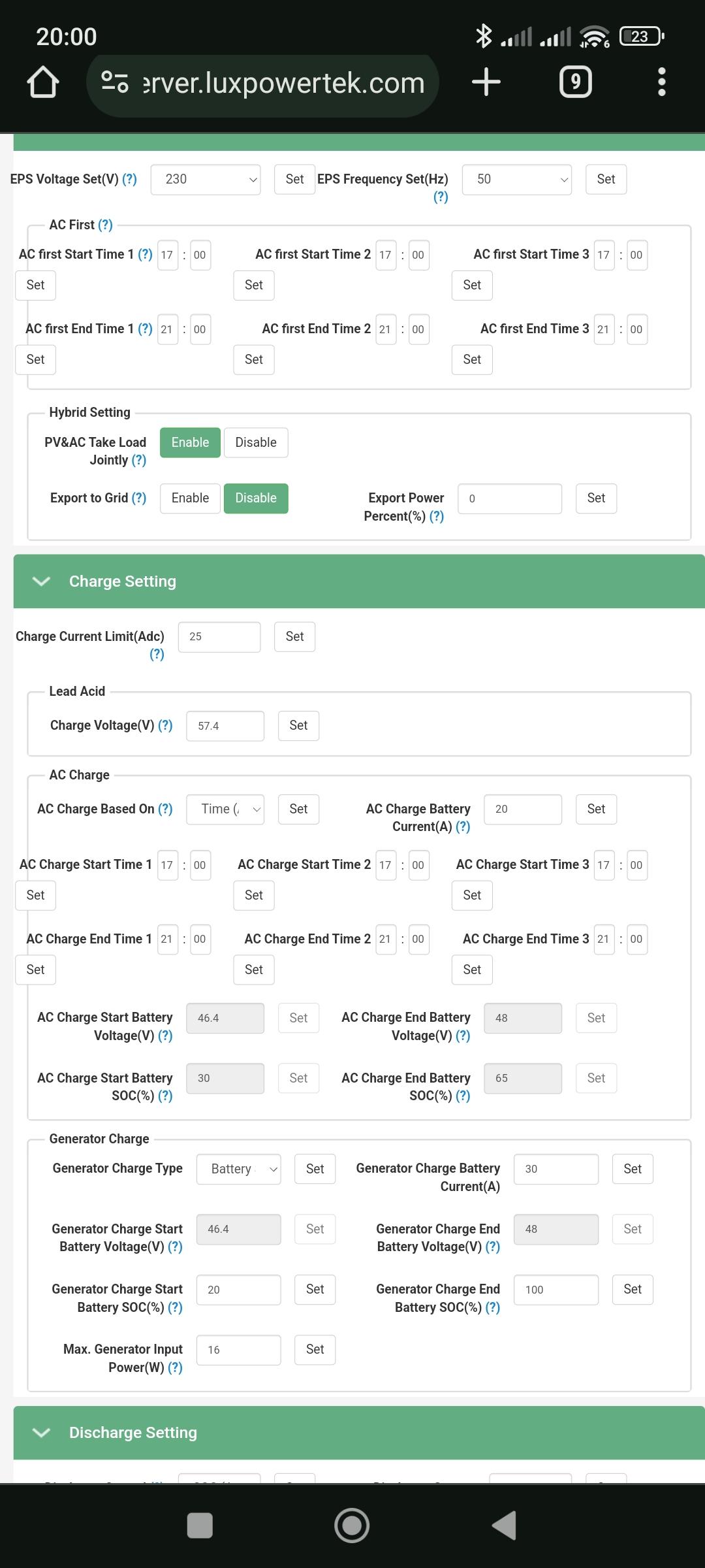

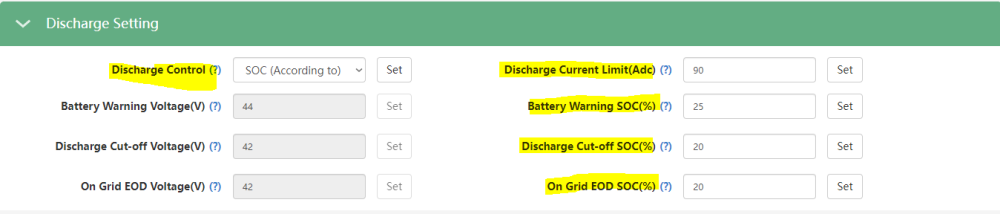

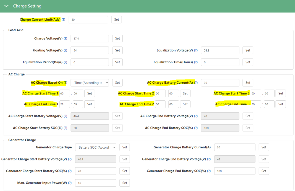

Then next please try the following settings and see if it makes any difference and prevents the inverter from tripping / giving an EPS overload error.
I assume in all instances, you are below 10KW output from the inverters?
So copy the highlighted settings above, this might not be ideal but it is just for testing purposes to ensure the inverters no longer trip or give you the EPS overload error. If that is resolved then we can tweak the above settings to suit your batteries and your needs better.
Let me know how it goes with the above settings in place and once you have confirmed the inverters are on the latest firmware and the parallel settings are done correctly.

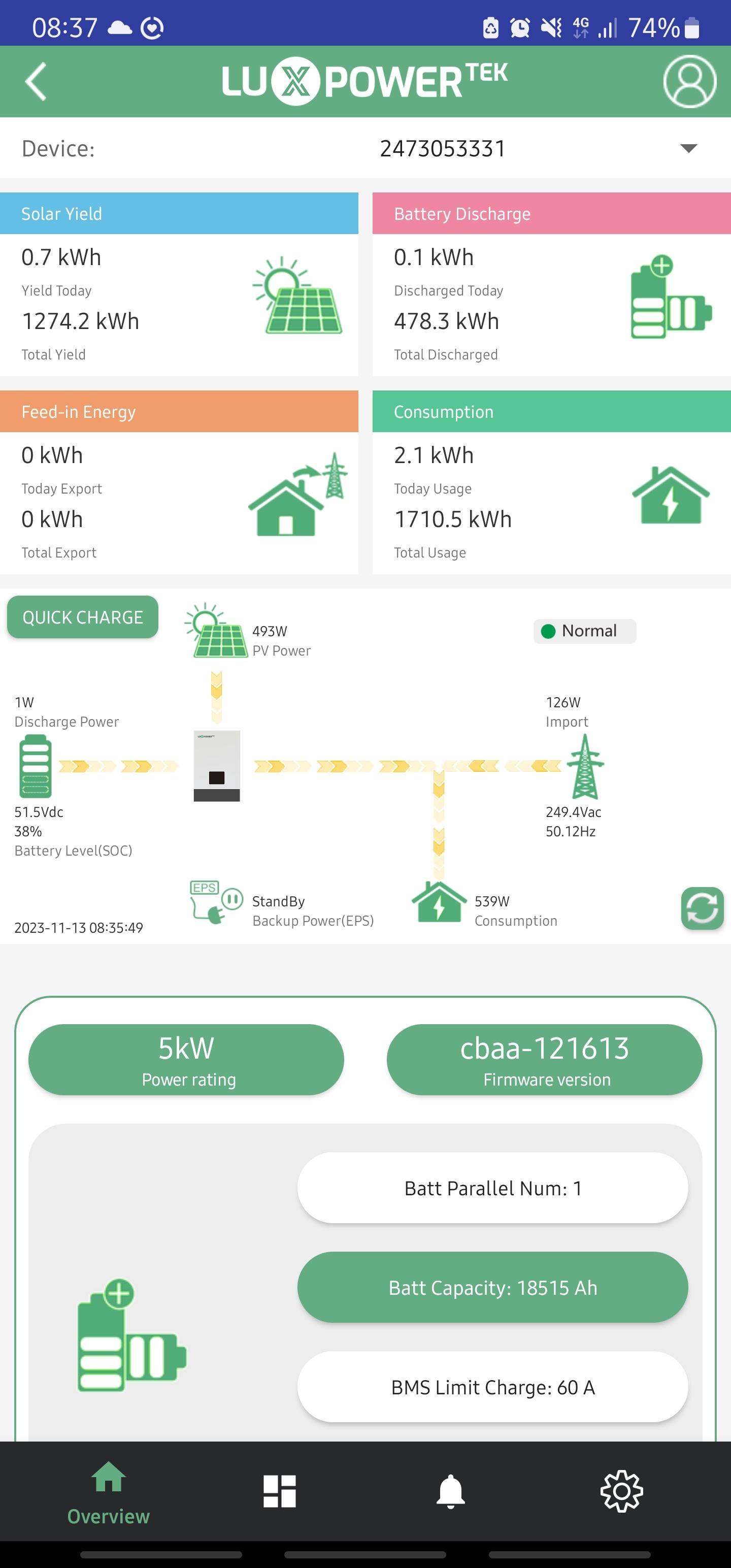

Here is the screenshot with the geyser on. I think in SUB mode it would draw from the battery too but I'm not sure. Maybe other people can confirm. Screenshot_20231113_102031_LuxPowerView.thumb.jpg.335fd34f5b3314be64f4317729060339.jpg
