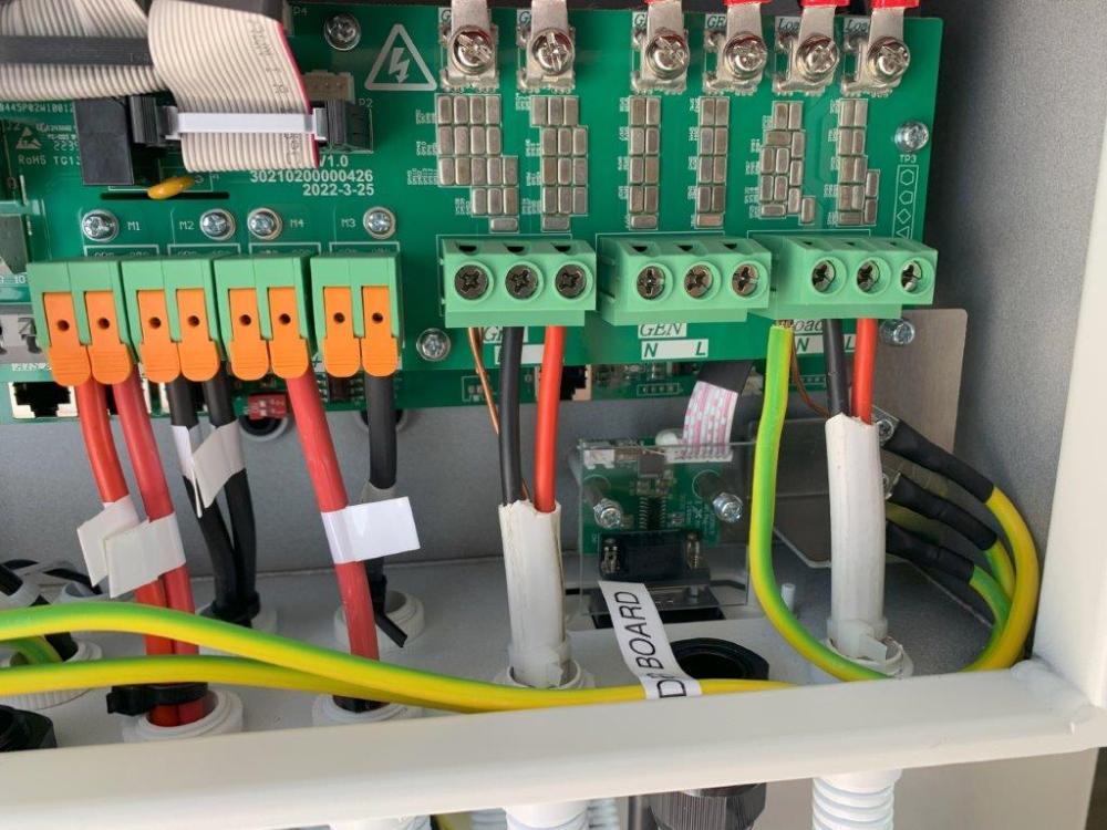

For an update, I have now completed the installation of my additional panels and thought it best to provide an update and provide some pictures/insights - I have also obtained a CoC for the installation - thanks to everyone for the input received above as this made it all possible 🙂 (with the CoC being the cherry on top 🙂 )
My Installation now consists of 8kw Deye inverter, 24 x Canadian Panels (10360w) and 2 x Dyness 5200 batteries - pictures of final installation below
I am very chuffed with the installation so a BIG thank you to all !

Nice install.
Very neat wiring there, motivational for me to pull finger and get my panels mounted too :D
