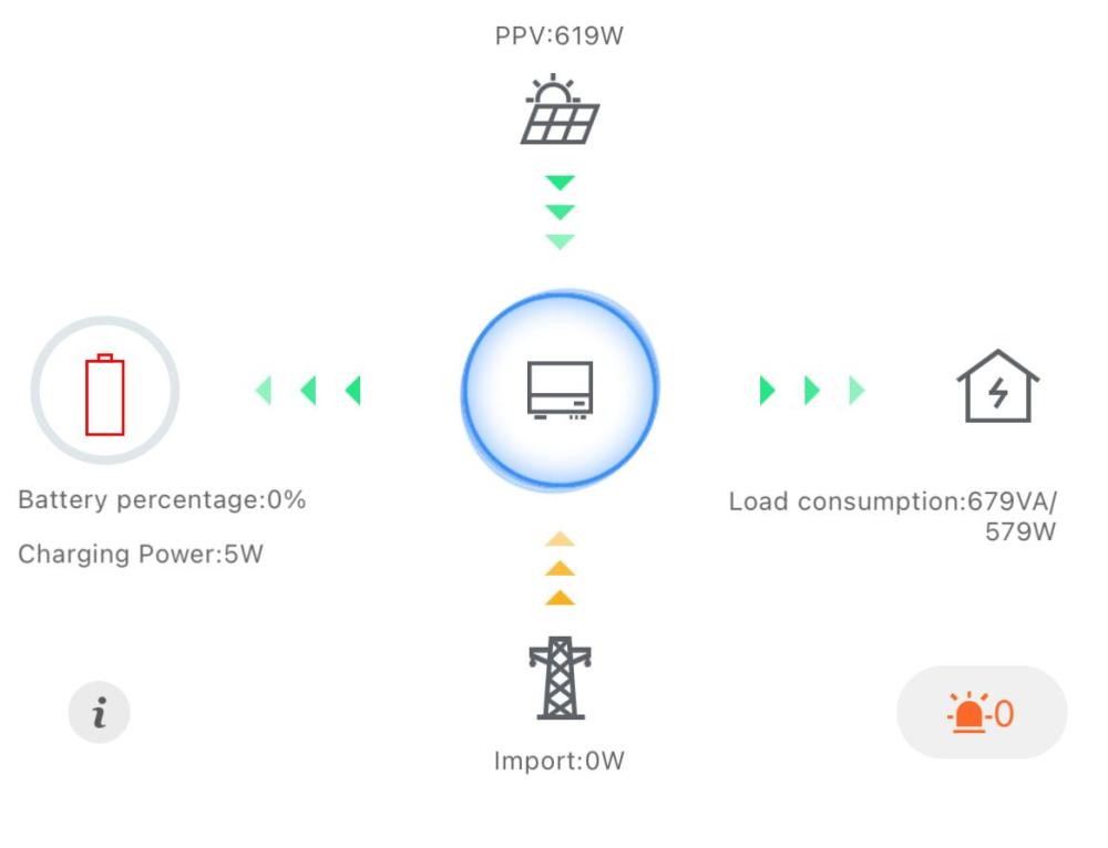

I am away for the weekend, however will send someone to the house to check on the error code shown on the inverter.  Installation is 3 years+ old.  New error, never recorded before.  System has not shut down.  System ran on import from Eskom from 20:00 last night (when battery soc dropped from 100% to 0% instantaneously) and currently from PV with no import.  No charge going to battery from PV as the soc remains 0%.  Battery in USE.  Will get the voltage settings from the inverter.  Will update once I get feedback.  Thanks
Based on the info provided the battery circuit could be open circuit. Either fuse blown, error in the battery switch or the BMS switched off.
Only my take based on the info available.

A blown fuse is highly probable seeing that the SOC dropped to 0%.
Can you still see any battery voltage on the app?
BMS would shut down if the voltage was out of spec.
Could also be a component failure on the battery side of the inverter or the BMS itself.

Spot on. I took the road of the items that one can check locally before removing the battery and inverter to be sent in for testing.
I only saw the battery drawing 5W which could imply the BMS is drawing some power or it is just a stray reading as one can see at times. This could indicate some circuit in the BMS has component failure as you suggested.
It still means taking a step approach to eliminate possibilities while testing on site.
