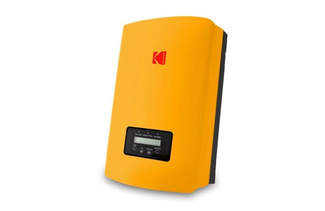

February 9, 20242 yr 1 hour ago, Coulomb said: Voltronic, the manufacturer of Kodak OG 7.2s and most if not all. Not all Kodak. The sexy Kodak with rounded top and bottom are actually rebranded Solis grid tied=string inverters.
