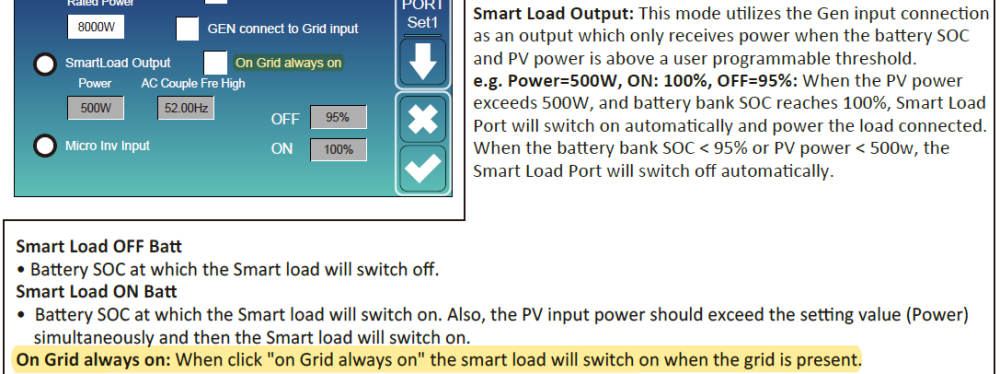

38 minutes ago, CobusK said:
When Grid is present, just tick"On grid always on" image.thumb.png.fb52637a72454c426a78fb43a13f04b7.png
Does inverse also apply.. Switch on when grid is not present however PV is there and battery SOC trigger level is met
Correct, if ‘Grid’ is ticked it’ll be on regardless when there’s grid.
When no grid, the parameters you specify here will apply.
Also note that the PV Power value on this screen is currently-in-use solar power (as opposed to total available power); so this value would be your household’s base load to trigger the port when there’s PV. You can’t specify the power rating of your geyser in this field unfortunately.
Otherwise, this should do what you’re after.
The user determine/program the threshold.  The value specified would be available PV, in excess of the base load required for normal operation.
