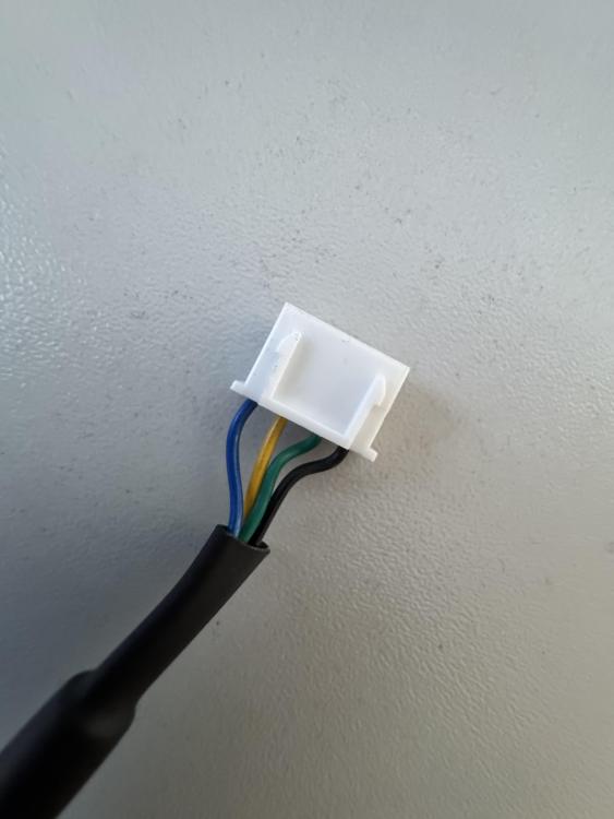

On 2024/09/15 at 2:51 PM, fhocorp said:
For the fans, i have the Noctua NF-A8 inside, and no problems at this time (temperatures are correct and the device consume about 5watts max on idle with a perfect silent operation).
I had the same idea. Did you need to change something on the connectors/pin layout or is it plug and play replacement?
Hi @Funstar
You have to modify the connectors and wiring to work. red is +12V, black is GROUND. Blue is PWM and the yellow is RPM signal.
Edited by fhocorp
add confirmation for fans pinouts

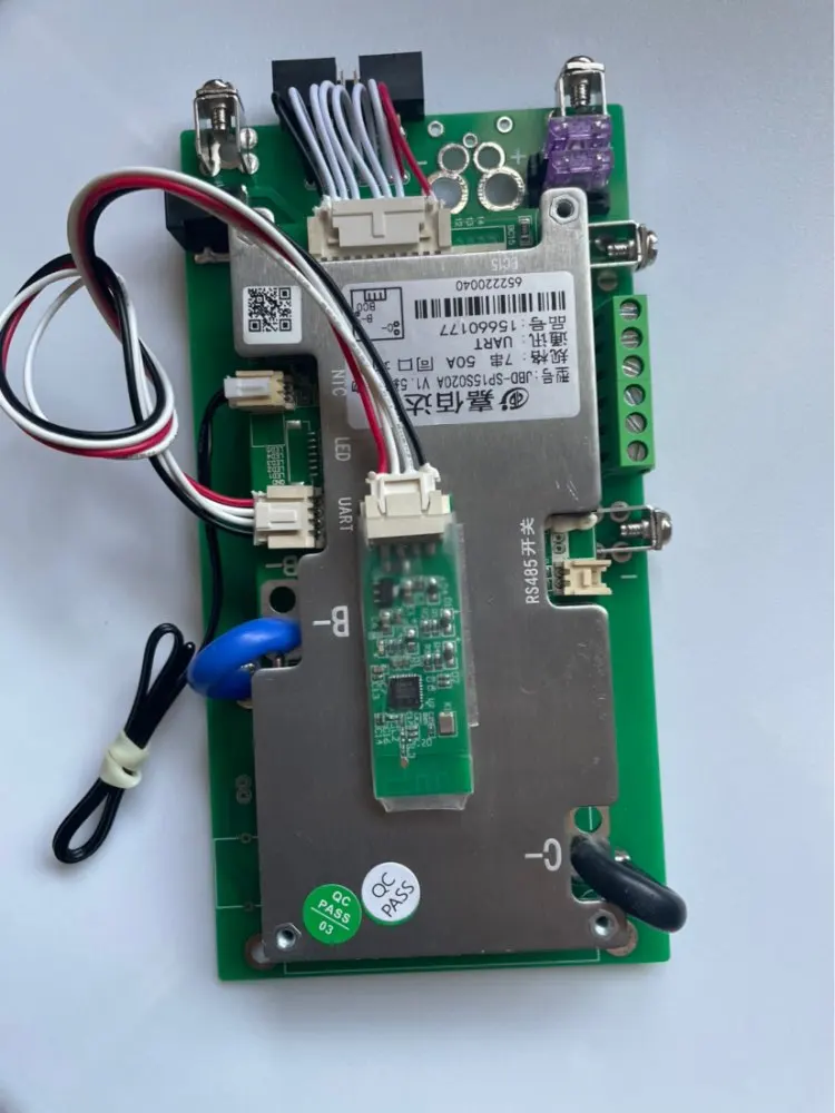

One question, on my inverter i have RS485 connector. Wiring is below :1iODJca.jpeg
and my battery is 18650 based whith a Bluetooth/RS485 BMS :
The RS485 connection is 2 Wire based and the inverter have 4 wire connector.
After some researchs, 2 wires a half duplex connection and 4 wire are full duplex connection.
I have tried multiples connections but nothing work (the "LI" icon keeping flashing as unsucessful connection)
Any ideas ?
Re the four wires: my understanding is that the two RS-485 pins are in parallel, as are the other two. So only two wires required.
12 hours ago, fhocorp said:
I have tried multiples connections but nothing work (the "LI" icon keeping flashing as unsuccessful connection)
My guess is that the BMS doesn't follow one of the six or so protocols that the inverter supports. Some of those protocols ae CAN bus only. If so, you'll just have to use battery type USEr, and enter suitable float, bulk, and cut-off settings. In that case, the inverter's SoC display will be almost completely useless; hopefully the battery itself, or its BMS, gives you a reasonable SoC indication.
Perhaps: a) check if indeed A and B are tied together in the connector, b) use a slave MODBUS software on PC, and an RS485/USB converter.  See what is sending the inverter using a PC software like https://www.modbustools.com/modbus_slave.html
A BMS protocol configuration implemented in some inverters is described here: https://workdrive.zohopublic.com.cn/file/vrz5k03066cc0152f4740b9bfff16dd8afe47
or, do nothing and let BMS to do it's job. 🙃
@Coulomb Yes that i have suspected. Actually, i have tested the 3 parameters for lithium :
- LI 2 : Lithium BMS for US2000C Pylontech (Not working in my case)
- LI 4 : Standard BMS Protocol (Not working, LI icon flashing without communication)
- LI 6 : Lithium profile without BMS communication (Working without problems but no SoC or temperatures measured).
In the next month i will switch to US2000C Pylontech batteries for safety and monitoring purposes. The Pylontech batteries will be connected to the inverter via RS485 and the Solar Assistant will receive the battery status via the inverter.
My 18650 Powerbank will remains in my testing part of my installation, with a link to another Solar Assistant via an USB-RS485 dongle. The second Vevor inverter will be used for my testing installation.
@rowesley  I will check this 😁  BMS communication is mandatory for me for monytoring purposes because i have to control the system outside of my home (and i am regulary away for work)
Edited by fhocorp

On 2024/09/29 at 4:48 PM, fhocorp said:
Hi @Funstar
Did it now, but get an error 14 (fan blocked), even I can see it spinning (but with very low airflow). Any suggestions?
Edited by Funstar
