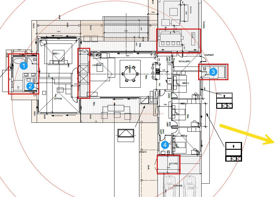

Here is a layout of the proposed plans!
1. Bathrooms are denoted with blue numbers.
2. Red blocks are concrete roof areas (rest is thatch)
3. Yellow arrow denoted North (for sun direction)
On 2024/06/17 at 4:24 PM, AlexanderR said:
  1. It's a permanent home!
  2. It's a fixed 5 person house.
I do like your idea about solar thermal and gas! There is already gas for the hob so it shouldn't be hard to add some extra piping to a gas geyser.
A Few Quick Questions
  1. If the solar geyser is on the roof, where is the gas geyser?
  2. Does it impact the pressure? Or where would the gas geyser go to keep the pressure?
  3. Any recommendations for a solar thermal geyser?
  4. We could also only do the gas system for the 1 side where there are 2 bathrooms nearby.
It isn’t a gas geyser as such - the gas system watches the water on its way out solar geyser, which runs through system like a radiator inside gas system.    If temp needs it, it fires up gas and the water is heated on its way through.
Pressure should be fine, but at family holiday home my experience of gas is that you should avoid mixer type taps, those ones with an arm that swings for temp and volume.      I would rather have two taps and water mixes post tap on its way to shower head.
Our non automatic is a Bosch one, probably stick to quality brands…
The gas systems come in different sizes, down to small undercounter ones for example at an island counter basin.   The gas itself must just be securely piped through house and you will need electricity there too.
