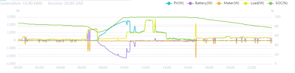

Here's my system on Sunday just gone
The yellow trace is the load. You can see the heatpump kick in for the first time at 6:30 (no solar at this time). Then about 12:00 the pump kicks in again. Now the pool pump is also running, so the yellow trace goes higher, but the increase in draw courtesy of the heat pump is about the same.
The pump is controlled by the built-in timer and thermostat. In the morning it gets just one hour. In the afternoon 2.5, but the thermostat will usually turn the pump off before time is up.
Note that the draw is such that I can run the heatpump on the backed up side of the inverter. You just won't to turn on the dishwasher, the kettle, and the toaster the same time the heatpump is running.
It does work a bit harder in the winter, but as I said, the morning run is limited to 1 hour, and this morning the water was a very pleasant 55 degrees when I showered.
