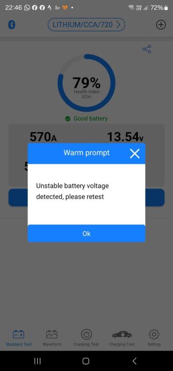

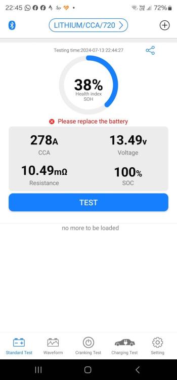

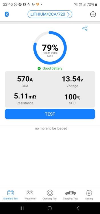

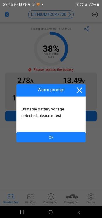

I have this Konnwei BK100 Wireless BT Car battery tester 100-2000 CCA 6V 12V - https://www.autosupply.co.za/product/konnwei-bk100-wireless-bt-car-battery-tester-100-2000-cca-6v-12v-bte-bk100/ - Though this I used to test my gel batteries, not sure if I can test Lithium with it.
I think I must let it charge for longer before I test it, I did earlier after only 4 hours of charging but it said something was odd about the voltage.
Edited by Ariel

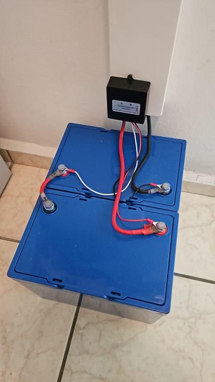

Assuming the battery tester I have works for Lithium batteries, does this look right? Is my one battery just needing a good charge that the score is so low?
Switch the inverter off remove the link in your picture below and test each battery individually i assumed that you did above tests with the series link intact. I don't know the tester you are using but give it a try without the link.
Ps after reading the specs of your tester i don't think the tester is compatible with Lfp or any lithuim battery.
Compatibility – It is compatible with all 6 volt and 12 volt lead-acid batteries, including regular flooded, AGM flat plate, AGM spiral, GEL, and EFB batteries with testing range of 100-2000 CCA. Compatible with cars, motorcycles, trucks, RVs, ATVs, SUVs, boats, yachts, mowers, and even golf carts
WhatsAppImage2024-07-13at19_23.00_89ef41a8.thumb.jpg.50e5b3b343a53c50f49fd14cdfea09ff.jpg.4d6cc252ebaa72a39f7fa76a67f43184.jpg
Edited by TaliaB
Added comments
Yes something is odd here if I may but in.
If the 2 batteries were charging for 4hrs there should be enough power in them to switch the inverter on and run a low load like laptop or TV at least for enough time. Even if the 2 batteries are out of balance.
If the above can work just measure the voltage of each battery at the start of this basic test and provide the readings.
Also check what current the inverter reports during charging if available on the screen.
As your pictures show the 2 batteries at different SOC I would disconnect both. Use another piece of wire as per your series connection.
Connect the 2xpos together and the 2xneg to put both in parallel and leave for about 3hrs. Do this with balanced disconnected. They would then balance faster than using the balancer. The balancer works gr8 ongoing.
Just my 2c.
Hi, you are right I don't think its compatible, I have someone coming to install something on DB board and he will test the voltage for me.
