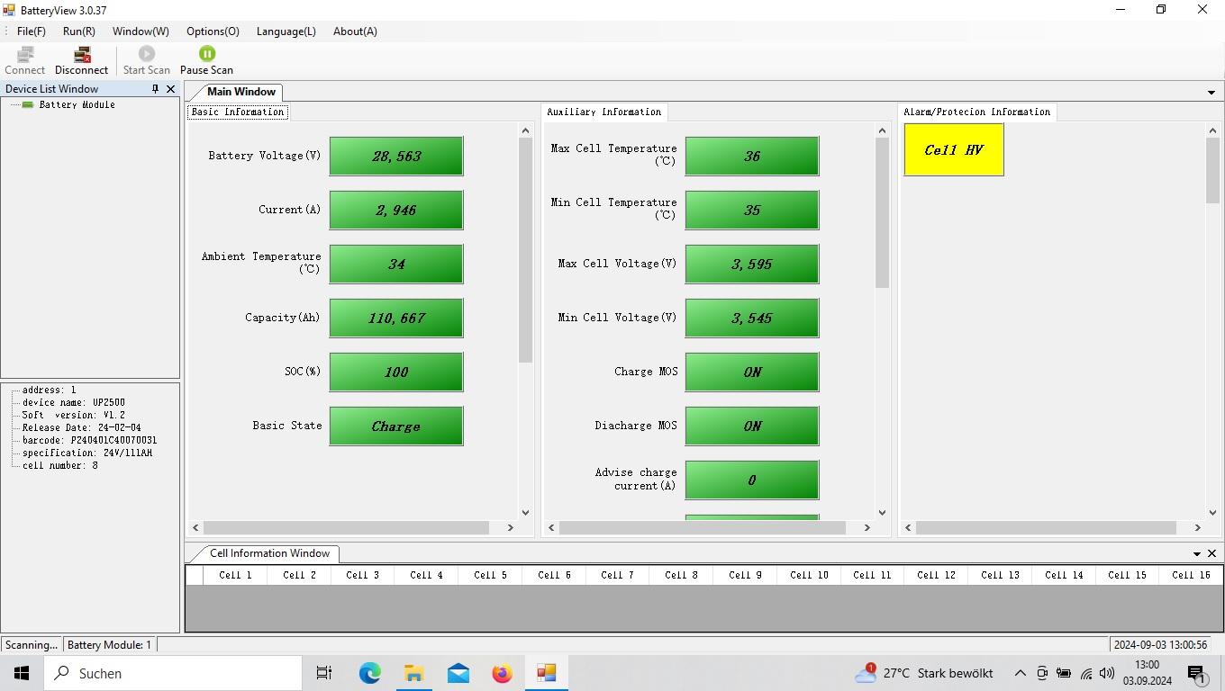

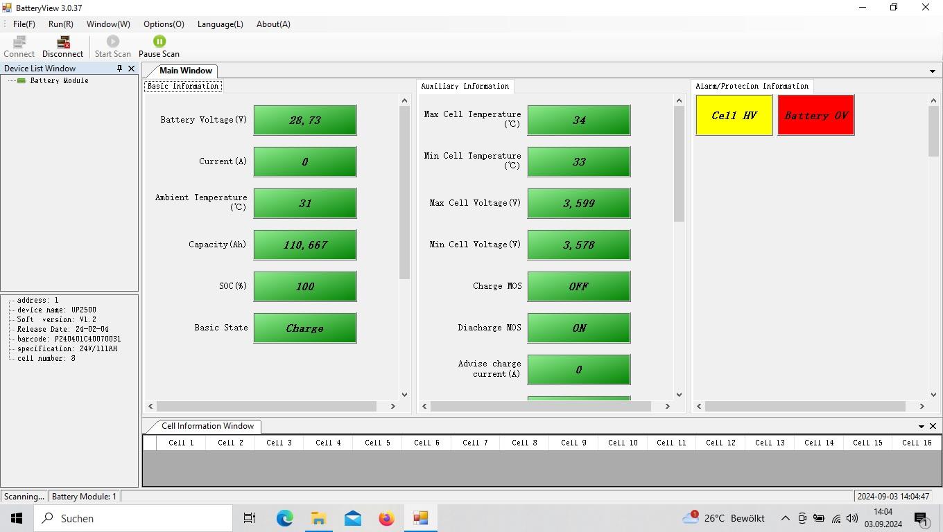

Hello, maybe someone can help me here. I have a Voltronic Axpert King VM3 inverter and a Pylontec UP2500 battery. I have already replaced the BMS cable. When I select “Watchpower” for the Pylon inverter with the software (preconfigured profile), I regularly get “Cell” High Voltage and “Battery” High Voltage with “BatteryView” and the battery occasionally switches to “Protect” mode. Furthermore, the battery switches off at 25 +-0.2 V (not at 23.3V or 24V). I get no support response from Pylontec. The inverter manufacturer has sent me the latest firmware and is of the opinion that it is due to the BMS of the battery. Does anyone have an idea how I can solve the problem? The battery is about 4 months old (bought new) and the inverter is about 1.5 years old (also bought new). The problem has existed since day one.

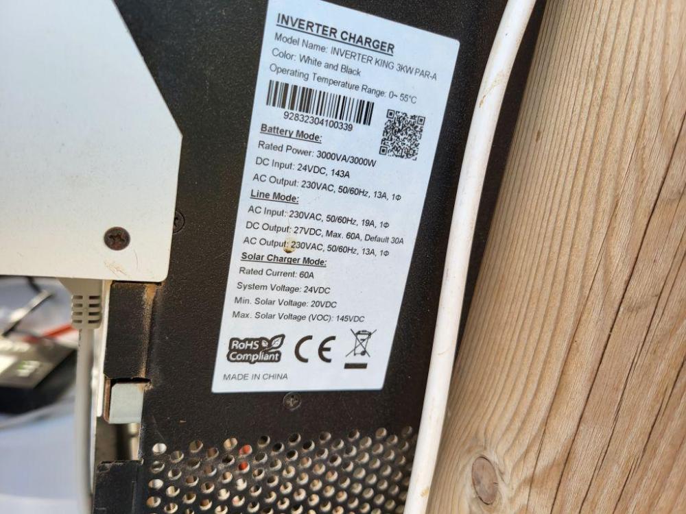

The VM III  and King models are very different. Perhaps you could post a photo of the sticker on the side of the inverter?

Hello Coulomb, here are the Photos.

Ok, thanks. So that's a King, not a VM III.

unfortunately, that didn't help. BatteryWatch and Viewpower now show the same volt figure (was different before), but when I activate the BMS, the battery gets High Voltage again, Cell High Voltage and then goes back into Protect Mode.
