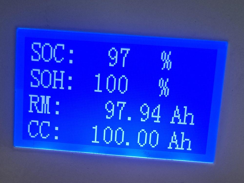

Hi all, I recently moved and took my inverter (5 Star 8Kw) and 2 batteries (N energy 48v 100 AH 4.8kw) with me.
With all the drama that comes with moving I haven't had a chance to re install the system. I decided to power up the batteries and noticed that the SOH on one battery is 100% and on the other one it's 28%?
The batteries both appear to be operating normally. Any idea why I am getting this low SOH reading or how to correct it?

The SOH is calculated using an algorithm on the BMS. I would reconnect the batteries and ensure both fully charge and possibly go through a discharge and charge cycle and check the SOH again. The algorithm should by then have reset and calculated the SOH correctly.

Hi Robbie, I am sorry but I really don't. I tried everything to get them talking to each other and the inverter. The supplier was 0 help. Tried running them down and charging them up together a few times. Tried leaving them connected to each other for a week or so to let them equalize... but nothing, I eventually gave up and got rid of them. I am sorry the news isn't better. Maybe someone here will have a solution for you
