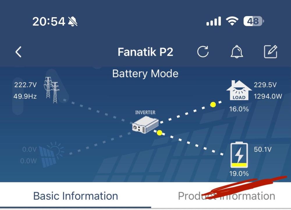

I have two 11 kW hybrid inverters connected in parallel. My issue is that one of the inverters measures the battery group voltage as 52.8V, while the other measures it as 50.1V. How can I resolve this issue?I have two 11 kW hybrid inverters connected in parallel. My issue is that one of the inverters measures the battery group voltage as 52.8V, while the other measures it as 50.1V. How can I resolve this issue?

Before this issue occurred, I experienced something unusual. While navigating through the inverter monitoring software on my computer, there was a sudden loud sound from the inverter, and it switched from battery mode to grid mode. It was a strong sound. When I checked the device, I noticed that the voltage dropped from 230V to 220V. Subsequently, the serial number changed, and a battery calibration issue arose.

I have absolutely the same setup of 2x11kW TommaTech Inverter in parallel and I face absolutely the same issue that 1 of Inverters (actually the Sleeve one) after each Restart (shutdown all Power supplies completely or Restart after Error with "Weak Battery" for instance) change its Serial Number and shows Lower Battery Voltage (also Lower: Grid Voltage, Output Voltage and Bus Voltage).
I restoring Original Serial Number and calibrating Battery after each Restart but this is not solution of course and I am looking also for proper/final solution.
