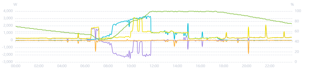

Here's the data from my inverter yesterday - and Deye will have a similar tool.
Yellow line is load. Green line is SOC. Blue line is PV. Yesterday was a nice sunny day, and we used about 13.1 kWh. But you can see most of the usage was during the day or early morning. At 6:30 the heat pump (water heating( turns on. When that finished, the SOC was 44% with the sun starting to come up. Then 10 o'clock you can see the pool pump turn on, followed shortly after by the dishwasher (which heats water, so makes a significant difference to the load).
Dishwasher finishes just after 11. Pool turns off at 15:00 - now look at our load. Very low. The spikes you see are most likely the electric kettle.
And this repeats this morning. Heat pump turns on at 6:30. By the time it is finished SOC is 51% and PV is just starting to get useful.
This isn't good luck or anything, this is the way we've planned it.
So check the data from your system and see what is going on at nights in terms of load. The more load, the quicker your battery discharges.

Anyway, the graph I posted came from my Goodwe inverter. The Deye will give you something similar, and you can use this to see when your loads are high and hopefully identify what they are.
