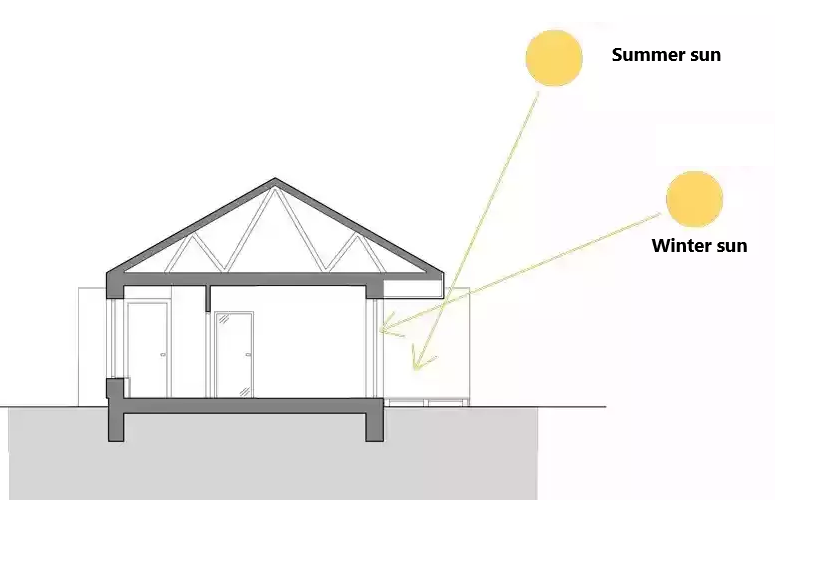

  • The Sun is 1000x more powerfull than A/C. The best combination is A/C + roof overhangs above the windows, in order to limit sunhine heating the floors.\

3. We have lots of roof overhangs for this reason, as well as special heat retardant plaster.
That really works well.
