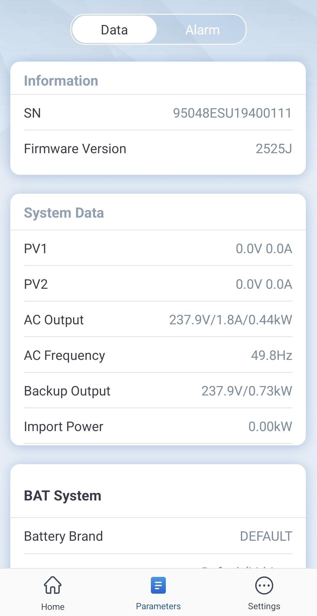

You'll find the grid data, the actual state of the grid that the ES sees (but may refuse to connect to) there.
You can see that I have 237.9V at 49.8Hz incoming, and the inverter has synchronised with that.
You'll also see the slider towards the top. Slide that to Alarm to get the latest error messages. These are sometimes not very clear.
If your ES is seeing any sort of grid then you will have numbers against AC Output & AC Frequency. If the voltage against Backup Output differs then the ES is providing backup to those circuits, but has not synchronised with the grid.
