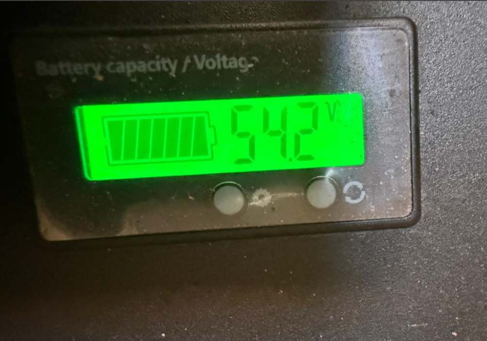

A friend in Pinelands purchased a battery with the advertised specification of 48 volts 150 a/h
The physical size is 450mm x 460mm x 190mm
However, this is only 40mm wider than my own Shoto 5.12kWH batteries
He found that if the AC is switched off at night, with an average load of 500 watts, the battery shut down after 7 hours
Either 1 - The capacity of the battery has been over-stated, or 2 - The battery is faulty
Any ideas?

  1. Is the battery shutting down or the inverter? Its a bit convenient for the battery to switch off at almost exactly 50% if we assume you continously run 500W for 7 hrs.
  2. Do you know exactly how many kwh this occurs at? Any energy measurement that shows many kwh is being used.

The inverter display showed 7.5 volts. I had to disconnect it, reset it and reconnect it. It took 11 hours to get it to 100%
