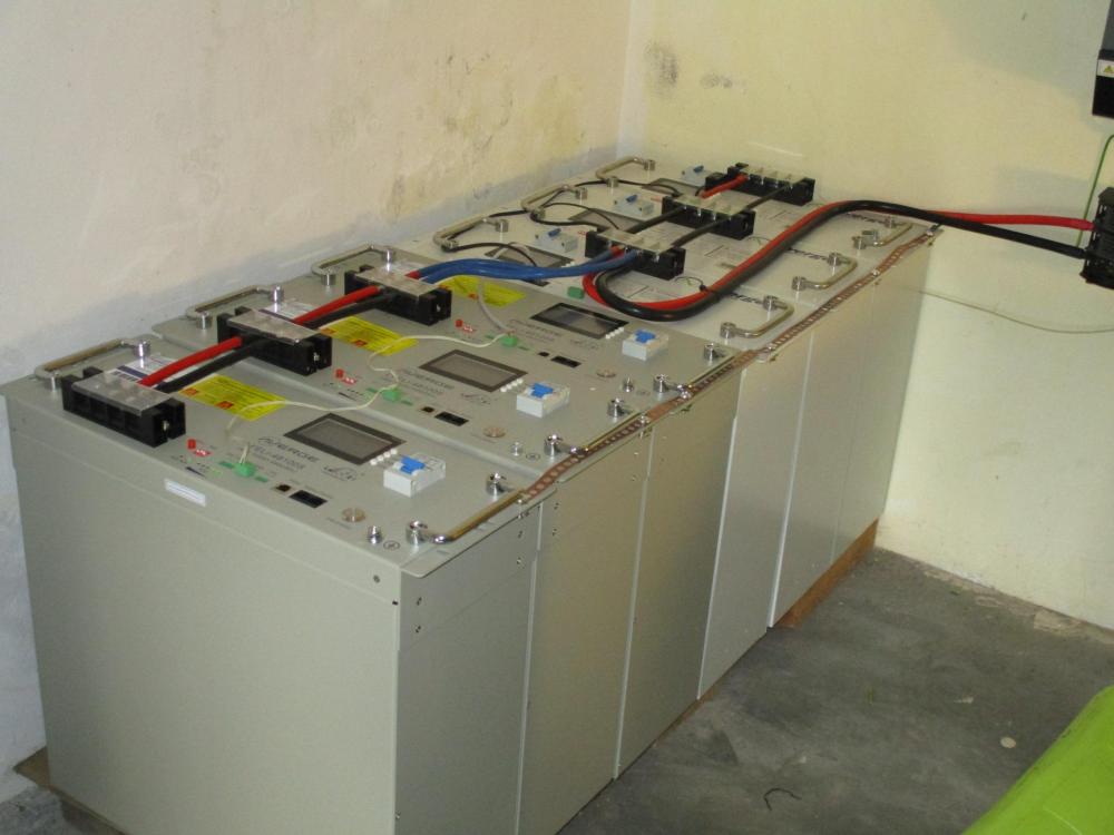

Do it rather like in my picture:
There are wood planks underneath the packs.
