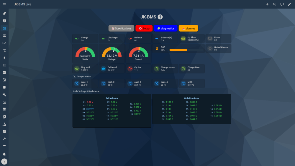

I have now found what I think is the simplest way to connect your JKBMS batteries to home assistant.
The data flows in very reliably at a decent rate (Almost realtime) and all you need is a simple rs485-usb adapter and the ability to follow some simple step.

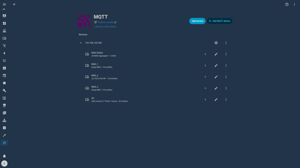

Data flows nicely into mqtt and exposes a crapton of data entities for you to use all over your HA where ever you like.

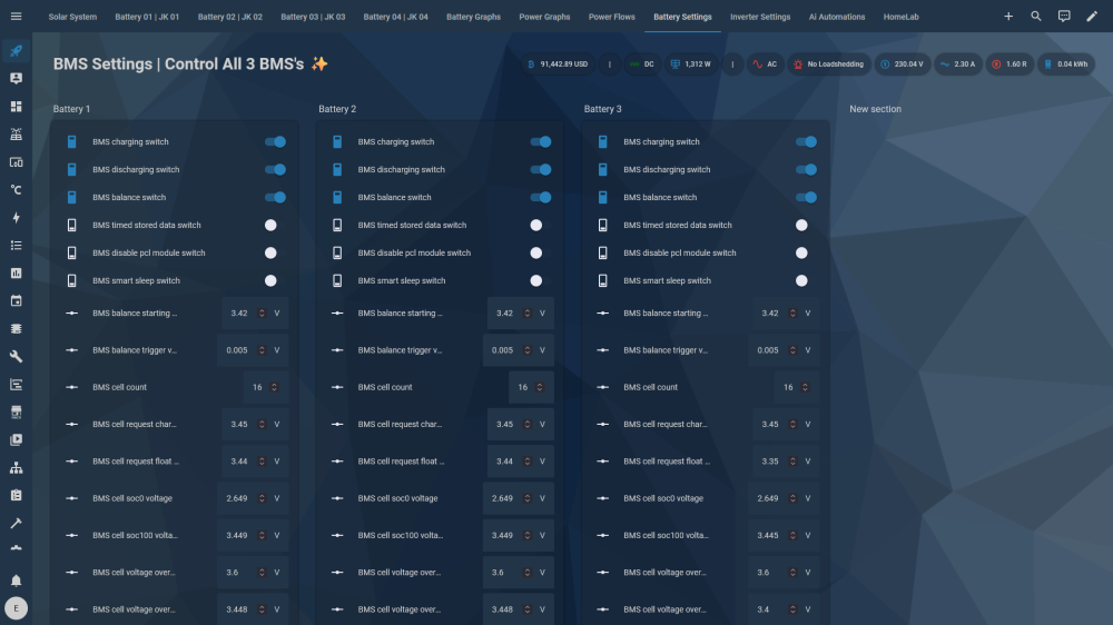

You can make adjustments to the bms settings right from inside HA
