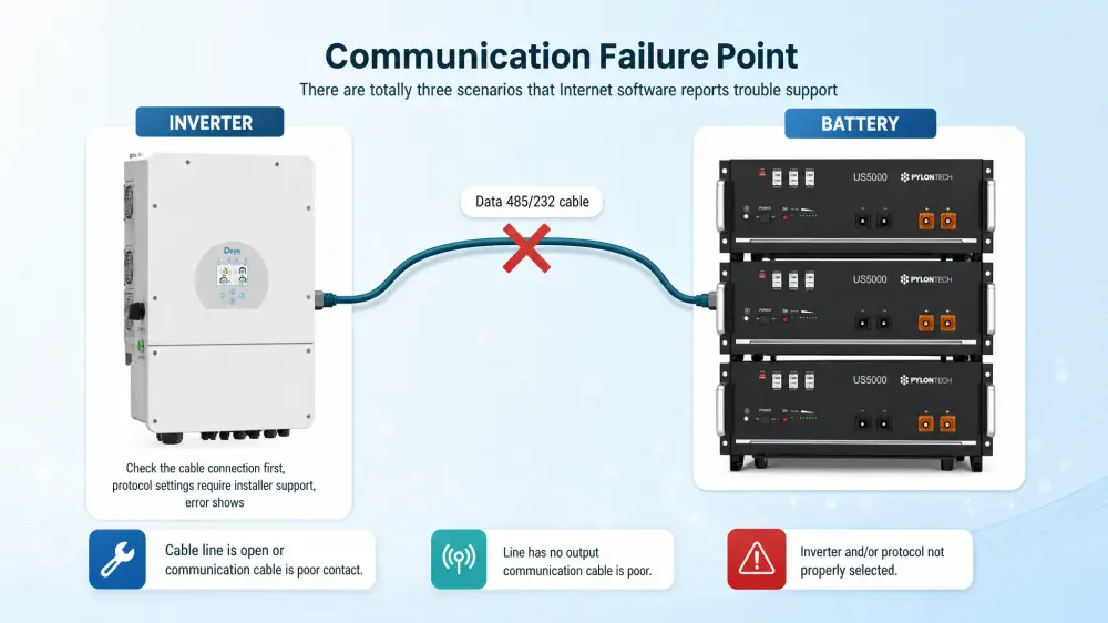

Communication failures may involve CAN cable, RS485 cable, inverter protocol, inverter settings, master battery selection, or internal battery faults. End users should only check visible cable connection and record the inverter error screen.
