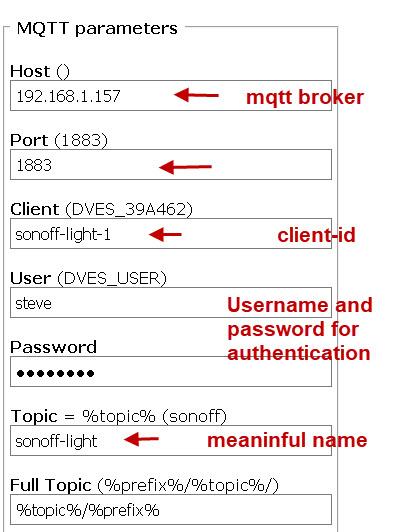

Did you set the Topic in the Sonoff Mqtt i.e. Sonoff-XXX  ?
think we still missing each other, yes, I gave it personalised name via the web interface (see below) in the tasmoto url once it was flashed.
See the attached picture... I've configured "Client" etc etc, I've configured the "Topic" to the same name as Client.What I'm mostly asking: for full topic... this can be %topic%/%prefix% or %prefix$/%topic%, which version/option is people preferring and why.
