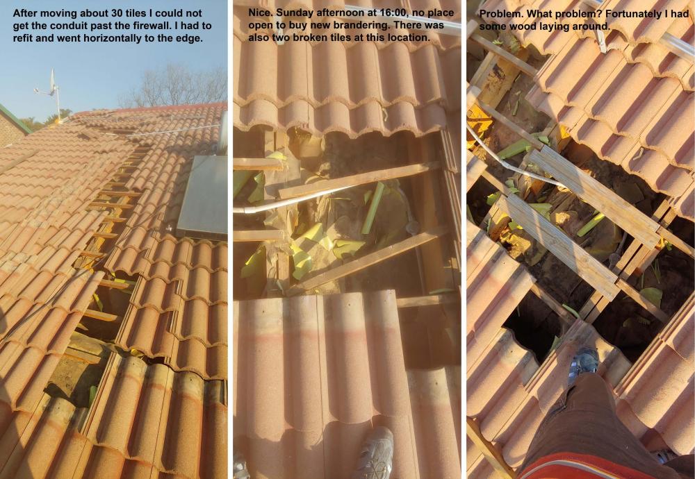

  6. Tiles will be broken. I only did a small section (one string) to lay the conduit for the wires, yet found 2 broken tiles when I lift other tiles. I glued them together using epoxy glue and marked them to ensure that I will never again walk on top of them. They were repositioned to be directly underneath the solar panels. The brandering below these two tiles were from two small pieces of wood.

  8. This seems logical, but I initially wanted to lay the conduit diagonally along the roof from the area where the panels will be installed to the location where it leads to the MPPTs. A firewall and rafters however blocked me at a few locations. After lifting 30 tiles I realized that there was no way that I will be able to fit trunking diagonally and had to refit all the tiles and went horizontally to the edge of the roof all along the brandering. Yes, my back was killing me sunday evening.
  9. Do not expect great work by the previous builder/roofer. I found a section where they used pieces of offcut brandering to install the roof tiles, which broke either while they installed it (and just decided to fit the roof tiles anyway), or it moved sometime when someone added a new light fitting to the room. Two sections were completely broken and were not even supporting the tiles properly. I was just lucky that it carried my weight and that I did not crash through the roof.
