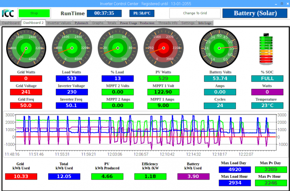

The following settings as per the pictures are currently configured on the ICC.
Your assistance with regards to optimum settings on the ICC would be highly apprecieated.

16 hours ago, Marcus Beneke said:
I would like to optimise the settings on the ICC to get the most out of my system and batteries whereby...
Your settings seem correct for your requirements.
Is there anything specific it's doing that you want to change?
