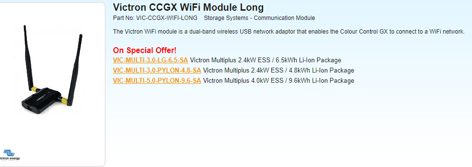

Hi Martin, @plonkster will soon tell you if I am wrong, The Asus acording to me is a windows plug and play adapter, CCGX might not be compatible  with that. The following 2 options will work. I guess ccgx has the "Drivers" for these. Yesterday we used a victron wifi module that plugs into the VE-direct port, but I can not find that on any spares list right now.

This one is on victrons list of compatibles but i cannot get it to work, i am busey with 3 installs and swopped ccgx cables and dongles and still no luck. starting to feel stupid or as if i am missing something very simple. used a older dongle from another up and running site and it worked first time.
