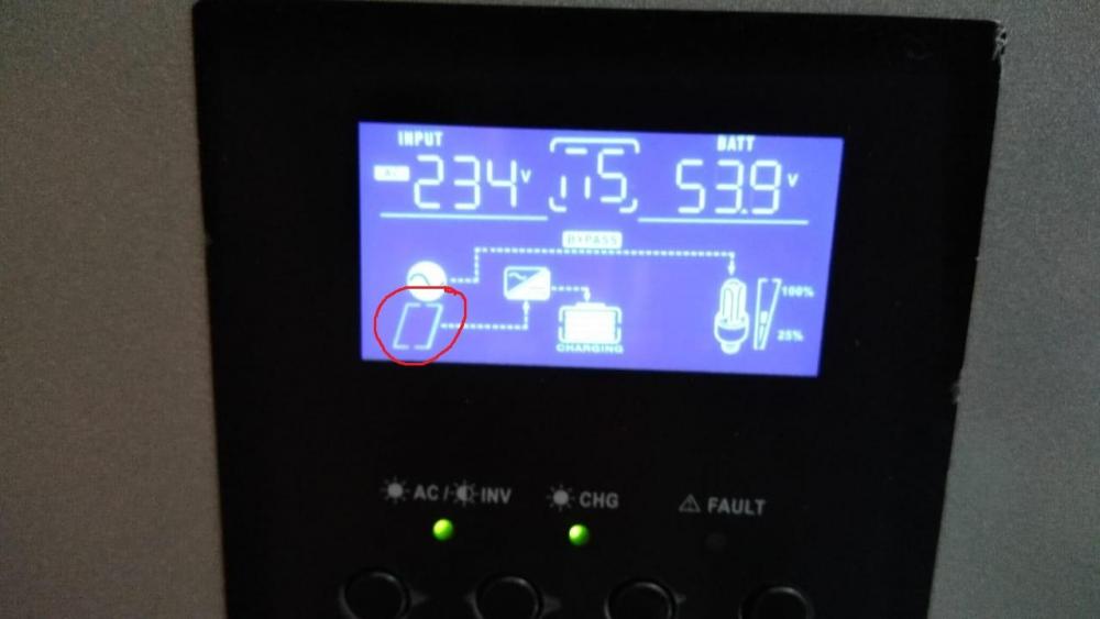

I want to know is this correct that this light never comes on ...
no matter if its on solar or SBU or just eskom.
it doesnt ever come on.
I can see from the "font" that you are running patched firmware. With patched firmware, the panel becomes a mini power meter (bar chart), showing 0, 1, 2, or 3 bars, for 0-499, 500-1499, 1500-2499, or 2500+ watts. Think of it as the number of kilowatts of PV power, rounded to the nearest whole number.
If you never see any "bars" in there, it means that your PV power never exceeds 500 W. The fact that you see at least the empty frame there means that you are potentially using some solar power, just not 500 or more watts.

wow...thanks..
patched??? never knew this..i bought it like this.....solar is working but the little lights dont come on
Thanks ..you are very clever
Ah. If your main firmware version is LC1_72_70c, then you likely have a clone that can't be firmware updated.
So the good/bad news is, you're stuck with these advanced features 😬
ok thanks...i looked ..and saw this version is LC1_72_70c.
i added more load on the weekend and saw the lights did come on...the more sun and more load brought the lights on as it works in steps like you mentioned above depending on the load..so far so good.
i would just like to have the option of flashing the firmware if i ever wanted too.
but everything is working 100%
thanks a lot clever man-xd
