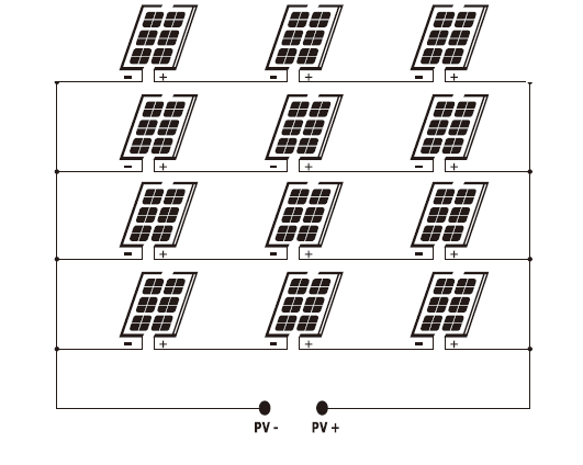

I have a 5kva inverter connected to 12x 260w  PV panels as below and it even shows this as a suggested configuration in the manual.
I've been monitoring it today and it seems like the solar output is much better when the PV voltage is below 100 volts for some reason.
The inverter is supposed to handle up to 145v but performance seems to be better at the lower voltages.
I'm now considering changing the PV connections to 2s x 6P to lower the voltage but I'm not sure if this is the best approach or if something else may be worth checking.
Any suggestions welcome.
There could be a chicken and egg situation here. When you draw significant PV current, the panel voltage falls. So the low panel voltage when production is good might be a result rather than a cause.
The PV power should not start ramping down till 130 V; I see that they are calling the upper end of the MPPT range 130 V now, till recently it was 115 V.
There is considerable work and cost reconfiguring from 3S to 2S. Especially if your panels are 60 cell (or 120 half-cell), I would leave them as 3S and try to find why the solar charge controller doesn't want to use PV power.
What is setting 26, bulk/absorb charge voltage? If it's 53.2 V for Pylontechs, then the reason for the low production is that your battery is full and you had low loads.
You must be psychic Coulomb.  The bulk charge is set to 52.3v and it is connected to 2x Pylontech batteries 😀.
I'll keep an eye on it today when it is under more load to check that the PV is keeping up with the demand.  I don't want to be using the batteries during the day.
