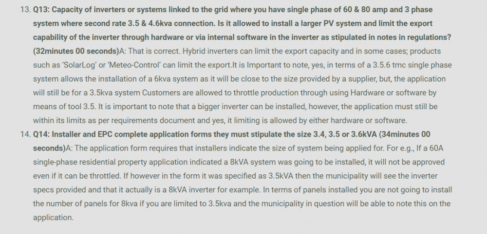

From the webinar on Nov 29 2019 it was stated that hardware/software limiting can be used to throttle it within spec:
https://arepenergy.co.za/city-of-cape-town-webinar-nov-2019/

no. You have to limit the maximum output power of the inverter (even if it is all self consumption). In my opinion it is complete nonsense and as far as I know only applied here in South Africa. The reason given to us when we queried it with the CoCT was that if all inverters would suddenly stop generating the grid would have to take up the slack.
